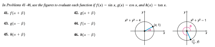

trying to do #41
\begin{align*}\displaystyle
\sin(\alpha + \beta)
&=\sin\alpha \cos \beta
+\cos \alpha \sin \beta\\
\frac{1}{4}\cdot\frac{3}{1}
+\frac{\sqrt{15}}{4}\cdot \frac{\sqrt{10}}{3}
\end{align*}
ok the book answer to this was
$$f(\alpha + \beta)=\frac{1-2\sqrt{6}}{6}$$
but I couldn't derive this

From the graph on the left, we have:
$$2\sin(\alpha)=1\implies \sin(\alpha)=\frac{1}{2}$$-
Hence:
$$\cos(\alpha)=\sqrt{1-\left(\frac{1}{2}\right)^2}=\frac{\sqrt{3}}{2}$$
And from the graph on the right:
$$\cos(\beta)=\frac{1}{3}$$
Hence (observing the terminal side of the angle is in the 4th quadrant):
$$\sin(\beta)=-\sqrt{1-\left(\frac{1}{3}\right)^2}=-\frac{2\sqrt{2}}{3}$$
And so we find:
$$f(\alpha+\beta)=\sin(\alpha+\beta)=\sin(\alpha)\cos(\beta)+\cos(\alpha)\sin(\beta)=\frac{1}{2}\cdot\frac{1}{3}-\frac{\sqrt{3}}{2}\cdot\frac{2\sqrt{2}}{3}=\frac{1-2\sqrt{6}}{6}$$
ok I had r=4 not r=2
