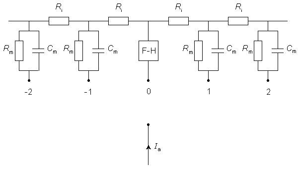

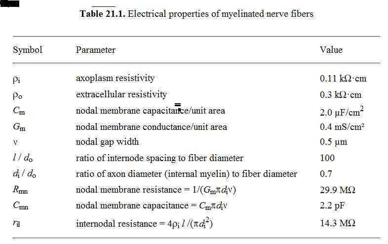

atyy said:
Capacity is not omitted - they are discussing resistor and capacitor in parallel as a model for the internode.
http://butler.cc.tut.fi/~malmivuo/bem/bembook/21/21.htm
Sorry, but I do not see it.
Granpa,
It is.

you do realize that the attached image in your last post, the one from the website here:
(in the case of dc, and neglecting the fh at the node, and using the water analogy for current) is just a description of a long empty and leaky pipe. you turn on the water and it takes a while before any comes out the other end.
it says the internode is just modeled as a resistor. the capacitors are for the nodes. doesn't make much sense to me.
That is the problem I'm pointing out.
Normally the nodes are connected to external milieu.
The above doesn't even model most nodes as active. HS discuss resistance and capacitance of the internode, and it is very important for them to come to the conclusion that the internode is passive, or at least much less active than the nodes (p328 bottom paragraph through p329).
Adding a capacitor doesn't change the passivity but it is missing (I added the table 2)
