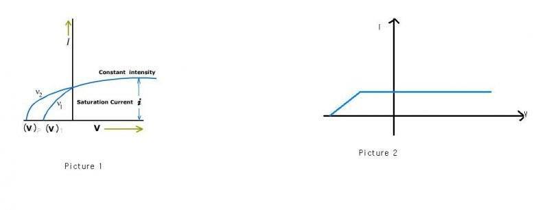

Sorry for the late reply, I was busy with the exam.
Sorry again because my question is not clear, so basically my question is:
Usually the graph of photoelectric current against voltage will be looks like this ( Picture 1)
Is it possible that we can get a graph looks like this ? (picture 2)
Not that I know of. That is way to abrupt, and in physics, we only see such abrupt change when there is something like a phase transition. No such thing is happening here. You are only collecting more and more 'stray' electrons. Nothing exotic here.
It still doesn't change the fact that there is a saturation current. Its existence doesn't require such an abrupt plateau to occur.
Zz.
Picture 2 is what we have seen in experiments with weak plasma's, where the charged particles created in the weak plasma are a function of the potential difference over the plasma. The zero-current is then at V=0 and the transition to the steady saturation current is in some cases extremely sharp (but still smooth). In our experiments, a stronger current causes (linearly) more charged particles to be captured and at saturation we capture all charged particles. The total number of charged particles created stays the same, independent of potential difference.
So a saturation current like figure 2 is possible, but maybe (probably?) not in your situation.
This is a simple photoelectric effect experiment. Haven't you all done this in your undergraduate physics lab? Most of the procedure often asks you to find stopping potential, but there's nothing to prevent you from applying a forward potential and measure this photo current yourself. So try it!
Zz.
