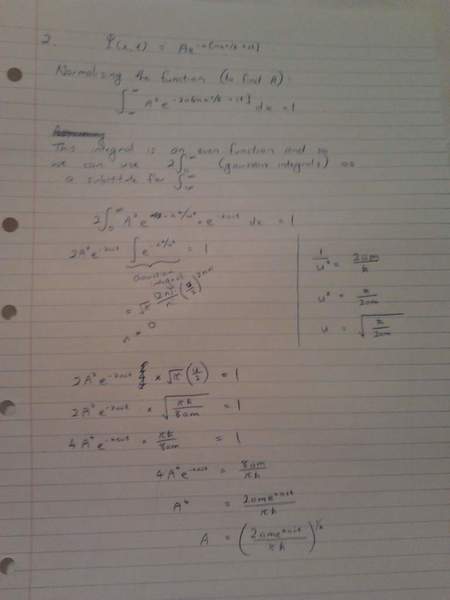

Here's my attempt, which took over 2 hours >.<
I hope the final answers are right, but am I going about it the right way?
Sorry the photos are blurry.

For the normalization, you have to integrate ##| \psi(x,t) |^2 = \psi(x,t)^* \psi(x,t)##. Time should disappear for the final result for ##A##.
I've check the calculation of ##V(x)## and you got it right!

Sorry the picture is really blurry. My final answer does have time in it:
[tex]A = (\dfrac{2ame^{4ait}}{\pi \hbar})^{1/4}[/tex]

And that is not correct. I think you forgot to take the complex conjugate.
If I do that wouldn't everything cancel out before I even integrate it?
[tex]\int_{- \infty}^{\infty} A A^* e^{-a[mx^2 / \hbar + it]} e^{a[mx^2 / \hbar + it]} dx = 1[/tex]
And so that would just become:
[tex]\int_{- \infty}^{\infty} A A^*dx = 1[/tex]
No, because only the imaginary part changes sign:
\left( A e^{-a [m x^2/\hbar + i t]} \right)^* = A e^{-a [m x^2/\hbar - i t]}

After a bit of working out again, I still think I'm missing something...
Even if I use $$
my integral becomes:
[tex]\int_{-\infty}^{\infty} A e^{-a [m x^2/\hbar + i t]} A e^{-a [m x^2/\hbar - i t]} dx = 1[/tex]
Which becomes:
[tex]\int_{-\infty}^{\infty} A^2 e^{-a m x^2/\hbar} e^{ -a i t} e^{-a m x^2/\hbar} e^{a i t} dx = 1[/tex]
If I evaluate the integral, I get the final result of [tex]A = \displaystyle \left(\frac{2am}{ \pi \hbar}\right)^{1/4}[/tex]
And then the time cancels out. So how would I get time left in the final result?

That is the correct answer. You might have misunderstood what I wrote earlier, but time should disappear from the final answer.
