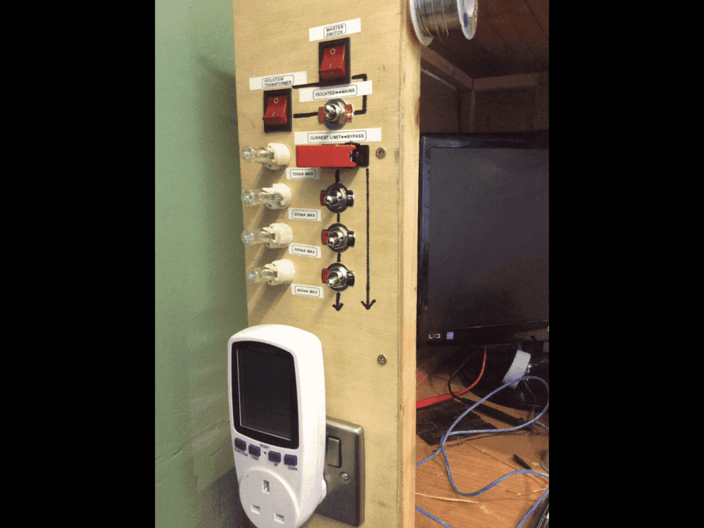

Ah, no - the supply is UK standard, but the isolation transformer is a rewound battery charger transformer, probably 300 VA or so. It’s just for powering up devices for testing, so I can scope them and flip the boards around without too much danger.
This and the variac (which is 2.4 kVA) will be used as part of my test supply panel:
Master switch turns everything off; second one toggles mains/isolated, and isolation tx can be turned off; next section allows a series bulb or complete bypass (‘missile’ cover so I don’t accidentally...); next three switches add in parallel bulbs to allow more current through in limit mode.
Finally, a decent socket with DP switch and a kill-a-watt type meter so I can measure what’s going on.
This will be for careful powering on of valve(tube) radios, and general solid-state boards with faults. This panel has been tested to UK standard:
Continuity/polarity.
Earth bond (send 30A through each Earth path (including switch bodies) to check integrity).
Insulation resistance (500Vdc between L+N and E).
Hopefully a useful addition to the bench!
Looks like a useful setup! :smile:
In that case, I'd probably downsize the fuse for your setup...
