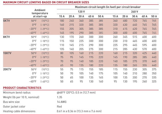

Hello,
Why do self regulating heating cables have such low power output per foot?
Power output in these cables does not exceed 20 W/ft at 10 degree C, and decreases as the temperature goes up.
Many of the cables I saw can withstand high temperatures (250 degree C power off and 150 degree C power on), so why can't we supply more current to get more heat density?
The manufacturers of such cables provide the maximum current to be supplied as a value per foot, so that the longer the cable the more current you can apply through it. Which I don't understand, what happens if I applied more than the max rated current in short cable, and made sure that heat transfer coefficient is high enough.
One of the cables datasheet here.
The table you attached is based upon each "circuit breaker's amperes rating" at the specified operating voltage and is designed so as to insure the minimum amperage required to deliver the cables rated heat output. It is not a general rating of the cable's maximum amperage rating.
The only way to get more heat is to increase the operating temperature of the cable so the limit may be based upon the maximum temperature limit of the cable's insulating sleeve material.
I don't think cable's insulating sleeve is what limiting the power output. If melting the insulating material was the problem, the cable could still provide higher power rising the temperature from -10 to 20 C, for example. If this was the case, the limit would have be on the working temperature not power output.
I might be wrong though.
Your question is best answered by contacting Pentair.
amrmohammed said:
So if I can supply more current, what puts a constrain on the power output? in other words, why can't I put 50 Amp through 180 ft with 120 V and have much more heat density than the 20W/ft that the manufacturer set as a limit?
you can't just supply more current .. .it doesn't work like that
The current flowing in the cable is limited/proportional to the voltage across the cable and the resistance of the cable
so for more current to flow ... ie more heat dissipation ... you either have to increase the voltage supplied or decrease the cable resistance
and if the voltage is fixed say your stated 120V ( USA mains supply), then decreasing the cable resistance is the only optionDave

I am not fixing the voltage input. These cables are made for oil and gas applications, so getting more than 120 V is not an issue. The 240 V cable also have ~ 20 W/ft limit. So, it is not the voltage supplied that put the limitation on power output, because the resistance change with changing cable length and we always have a maximum power of 20 W/ft.
I started to believe that the limitation come from the constrain of heat transfer coefficient (q = hc*A*deltaT) since the area of the cable "A" is very small (area facing object to be heated, cable thickness = 0.3 inch) and "hc" (heat transfer coefficient ) can only be as high as 1,000 W/m^2.C for air force convention, heat that can be transferred is limited. Thus, applying more current will yield higher power but only small amount of power is allowed to transfer and the rest will build up and increase the temperature of the cable, eventually melting it.
Let me know what you think
They don't specify" the maximum current to be supplied". They specify how much current a given length of cable will draw from the supply so you don't overload the breaker.
They are two core and the power is generated by current flowing between the cores not down them. Increasing the length is like adding elements in parallel. It increases both the total current and the power drawn.
You probably could design a cable to give a higher power density but these cables are typically intended to prevent pipes freezing in winter rather than heating water to make coffee ;-) Even for applications like under floor heating you only need 100-200W per square meter. Any more and the floor might get too hot for comfort. That's the same order of magnitude as 20W per linear foot of cable.
