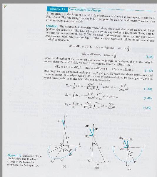

See figure attached.
The question I have is with regards to, [itex]dE_{x}. dE_{y}, dE_{z}, dE_{h}[/itex].
First,
[itex]dE_{z} = dEcos \alpha \quad \text{(form of z component of spherical coordinates)}[/itex]
[itex]dE_{x} = -dE_{h}cos\phi = -dEcos\phi sin\alpha \quad \text{(form of x component of spherical coordinates)}[/itex]
[itex]dE_{y} = -dE_{h}sin\phi = -dEsin\phi sin\alpha \quad \text{(form of y component of spherical coordinates)}[/itex]
Is there something to take away from this? He does this problem as a line integral in each direction respectively, but can I do it in one line integral? If so, how would I set that up?
Edit:
Here's my attempt at it. (See 2nd figure attached)
I didn't end up getting to the actual answer in the textbook, but it appears as though I'm pretty close. The answer they give is,
[itex]\frac{p_{l}a}{2 \epsilon_{0}(z^{2} + a^{2})^{\frac{3}{2}}} \left( \frac{-a}{\pi}\hat{i} + \frac{z}{2} \hat{j} \right)[/itex]
My y-component disapeers as it is supposed to, and if I pull out a factor of, [itex]2\pi[/itex] from my vector, I get part of the form we're looking for in the answer. My x-component is missing a factor of a, and my z-component a factor a z and I have a root(2) sitting in the denominator.
So the final answer I obtained, trying to get it as close to theirs as possible,
[itex]\frac{p_{l}a}{2\sqrt{2} \epsilon_{0}(a^{2} + z^{2})} (\frac{-\hat{i}}{\pi} + \frac{\hat{j}}{2})[/itex]
I don't know if I am totally wrong, or if I just screwed up one portion of the problem.
Any ideas? Does anyone see any problems?

You are on the right track, but I would have written down separate expressions for Ex and Ez. You have the magnitude right but not the right parts. See the attached.
