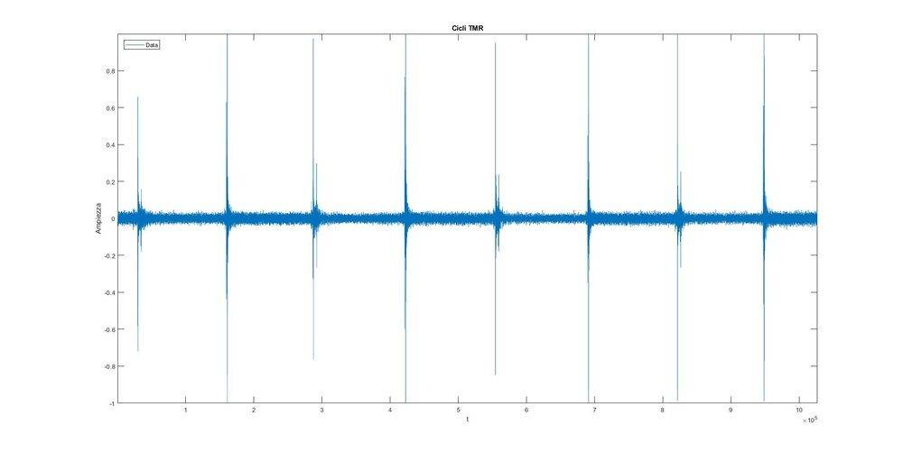

Hi,
I made the proof and I notice the piston behaviour is not the same on the outward and inward travel.
For example the damping time changes.
How can I convert this information in a tension [V] on a machine?
Better than I expected! The obvious approach would be to set up a comparator to detect the transients - this will tell you when the piston passes. Then, if you want more information, use an A/D converter to digitize the pulse shape and do some conclusions from that.
