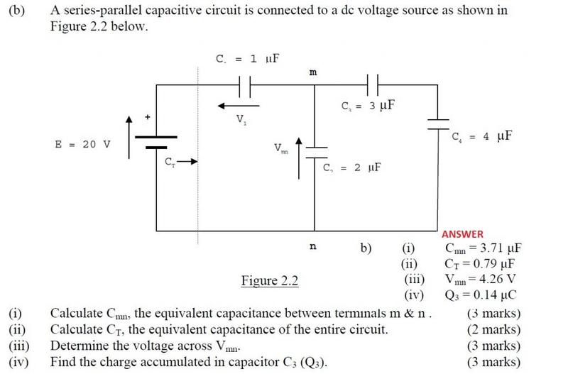

Hi there, can someone help me check if the answer for part (iv) is correct? I got 7.26uC.
Thanks.
Yes, your result looks correct. Also, the "ANSWER" for part (iii) looks slightly off, too. Should be more like 4.24V rather than 4.26V.
So the Answer key guy gets 6 marks out of 11 from me :smile:
lawl.. phew.. i thought i was wrong, i have been doing this question for the whole day..
