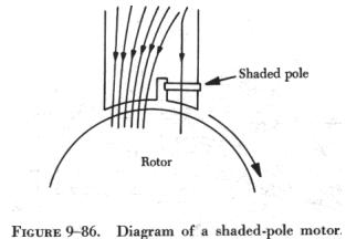

http://avstop.com/ac/apgeneral/typesofacmotors.html
The first effort in the development of a self-starting, single phase motor was the shaded pole induction motor (figure 9-85). This motor has salient poles, a portion of each pole being encircled by a heavy copper ring. The presence of the ring causes the magnetic field through the ringed portion of the pole face to lag appreciably behind that through the other part of the pole face. The net effect is the production of a slight component of rotation of the field, sufficient to cause the rotor to revolve. As the rotor accelerates, the torque increases until the rated speed is obtained. Such motors have low starting torque and find their greatest application in small fan motors where the initial torque required is low.

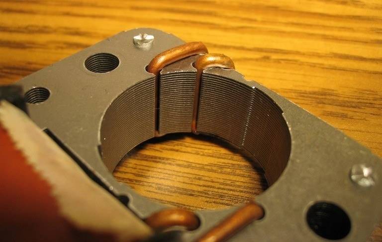

jim hardy said:A shorted turn around part of the core gives an out of phase flux which when added to main flux makes a rotating flux.
jim hardy said:They're easy to spot by the heavy copper shorted turn.
Prevalent in blower fans and small appliances.
Current in the shorted turn lags, making an out of phase flux.

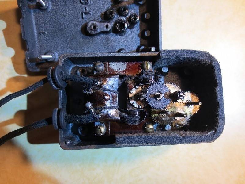

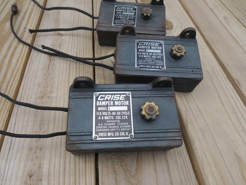

Yes...they...are. Thanks for educating me. I pulled this out of one of my piles. It WILL become beautiful.jim hardy said:They're easy to spot by the heavy copper shorted turn.
... Such motors have low starting torque and find their greatest application in small fan motors where the initial torque required is low.
dlgoff said:I pulled this out of one of my piles. It WILL become beautifu

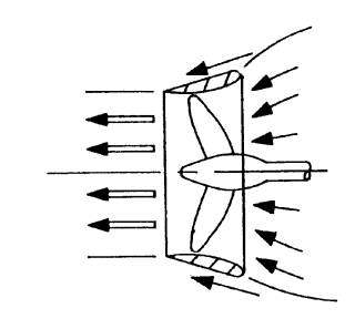

Good call. Any design experience as to getting "good" airflow? You know, working well is one of my design task.jim hardy said:That'd look cool with an old wood model airplane propeller . Engineer's fan...
Perfect.jim hardy said:
