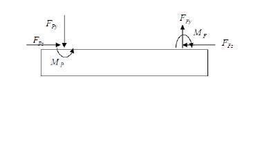

Shear and moment diagram--Need help!
On the attached question:
Fpy = 10 N
Ffy = 10 N
Mp = 0.15 Nm
Mf = 0.45 Nm
Draw the shear and moment diagrams.

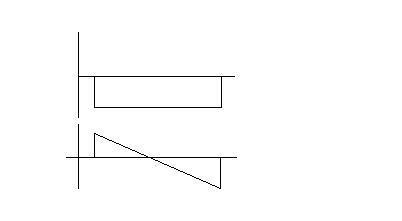

If you look at the answer I posted, I believe the shear diagram (top) is correct. I'm not sure about the shape of the moment diagram though. Perhaps it would slope to zero on both ends. Any suggestions? Thanks!

We would not know, because you did not show the supports on your first diagram.
