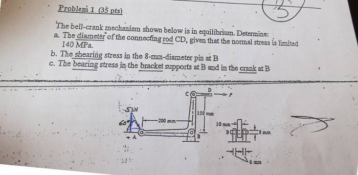

Textbook problem figure of a bell-crank mechanism: a 5 kN force at 60 degrees acts on point A, a 200 mm horizontal link runs to pivot B, a 150 mm vertical arm rises to connecting rod CD at the top, with pin B detailed at right showing 10 mm and 8 mm dimensions and a 6 mm bracket.
first what's the difference between bearing and shear.
I managed to solve a easily.
for part b i calculated fb(√(bx^2+by^2) and divided by ∏*4^2
I don't know how to solve c.
