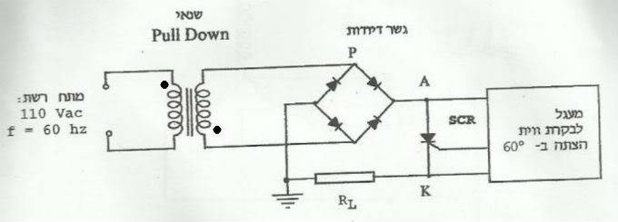

Hmm, Vp to the ground isn't the negative pulse.
It's the positive pulse.
Perhaps you should try to solve the circuit for a couple of voltages.
I think RL (and not its end where you have written "K") should return to the rectifier junction where you have Earth wrongly connected.

Your full wave bridge rectifier connections look much better.
VP starts from the negative input
http://img525.imageshack.us/img525/927/ppppv.jpg
VP would only be a negative voltage if your transformer secondary were [itex]180^o[/itex] out of phase (as in dot notation of following figure) However, when they don't explicitly use dot notation, we assume the secondary is in-phase (What does that mean? what ILS also alluded, VP-to-Gnd is the positive voltage).
I don't see where you are taking the pull-down voltage into consideration. Perhaps you could say in you calculations [tex]V_{A-G}(max)[\frac{N_ב}{N_א}][/tex]
http://i1131.photobucket.com/albums/m543/loxandbagels/scrcircuitwithpulldownxfmr.jpg
From some reason I always thought that it's the other way around...
http://img838.imageshack.us/img838/9165/oppositenormal.jpg
But you're my source, Quab, so I'll amend my err and instead of the dotted line for VP I'll add a full line indicating there's a voltage there, and at negative wave there isn't. Much appreciated

Regardless of the orientation, opposite or normal, Vp always has to be higher than the Earth connection (0 V).
If Vp were lower than the Earth connection, you'd have a short circuit.
