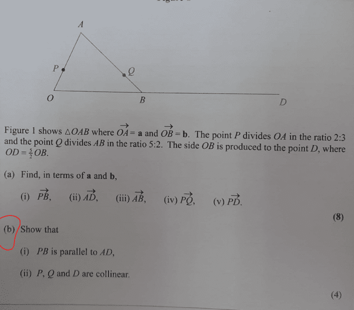

See attached
Vectors
Geometry figure of triangle OAB with O at bottom left, A at top, B on a horizontal line; P lies on OA, Q lies on AB, and the line OB extends to D beyond B.
My interest is only on part (b),
For part (i), My approach is as follows,
##PB=PO+OB##
##PB=-\dfrac{2}{5}a +b##
##AD=AO+OD##
##AD=-a+\dfrac{5}{2}b##
Therefore, ##PB=\dfrac{2}{5}AD##
For part (ii), we shall have;
##QD=QB+BD##
##QD=\dfrac{2}{7}AB+\dfrac{3}{2}b##
##QD=-\dfrac{2}{7}a+\dfrac{2}{7}b+\dfrac{3}{2}b##
##QD=\dfrac{25}{14}b-\dfrac{2}{7}a##
also,
##PQ=PA+AQ##
##PQ=\dfrac{3}{5}a-\dfrac{5}{7}a+\dfrac{5}{7}b##
##PQ=\dfrac{5}{7}b-\dfrac{4}{35}a##
Therefore,
##PQ=\dfrac{1}{7}\left[5b-\dfrac{4}{5}a\right]##
##QD=\dfrac{1}{7}\left[\dfrac{25}{2}b-2a\right]##
It follows that,
##PQ=\dfrac{5}{7}\left[25b-4a\right]##
##QD=\dfrac{2}{7}\left[25b-4a\right]##
##OQ=\dfrac{2}{5} PQ## thus shown as there is a scalar connecting the two...seeking any alternative approach and i hope my working is correct as i do not have solutions to these questions...
for (b) (i) I find it correct
for (b) (ii) there seem to be some typos after the phrase "It follows that" please correct them. For example I think it should $$\vec{PQ}=\frac{1}{5\cdot 7}[25\vec{b}-4\vec{a}]$$ and the final equation should involve PQ and QD not OQ(?)

Ok...I will check on that ...
The correct final equation should be ##\vec{PQ}=\frac{2}{5}\vec{QD}##, at least that's what i think.

That should be correct...my working is fine, but the division part at the end was wrong...

Amended to ##QD##...I will amend division part later, using my android to type...
I find the expressions of PQ and QD wrong after the phrase "It follows that" regarding the multiplicative constant of each, please review and try to correct them.

Yes I will...thanks for your input...

We ought to have;
It follows that,
##PQ=\dfrac{1}{35}\left[25b-4a\right]##
##QD=\dfrac{1}{14}\left[25b-4a\right]##
##35 PQ=(25b-4a)##
##14QD=(25b-4a)##
##35PQ=14QD##
##PQ=\dfrac{14}{35} QD##
##PQ=\dfrac{2}{5} QD##
