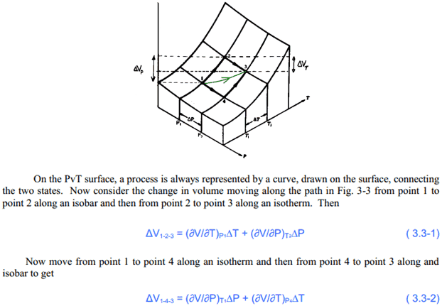

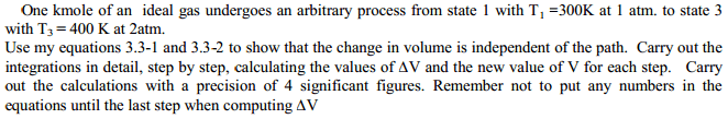

I understand what the question is asking. Both ways I should get the same answer. I'm having trouble figuring out the mathematics behind this question.

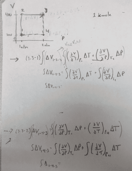

So would I have to change the equation of state around and plug it into each change of V, change of T, and change of P?
Edit: I should plug them into the partial difference equation? The change in should be constants I think.
Edit(again): The only equation I really have to plug in is V=(RT)/P. I think I'm just taking different differentials followed by integration.

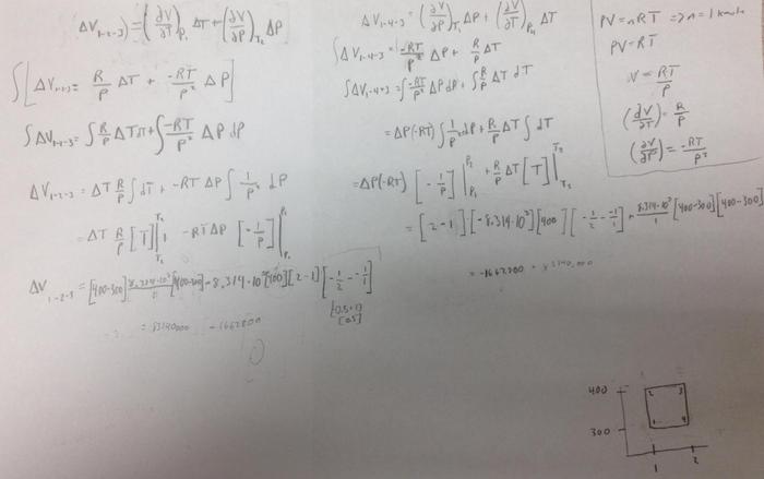

Here is the work I have done so far. I did use the equations but I was having a hard time understanding in my mind the final values to plug in specifically for the final T value. I assumed it was referring to the final state so I plugged in 400 K. Please let me know if I made any mistakes.
Thanks again for the help.
Ok, you have to be careful when integrating. First with:
ΔV1-2-3 = ([itex]\frac{\partial V}{\partial T}[/itex])P1 ΔT + ([itex]\frac{\partial V}{\partial P}[/itex])T2 ΔP,
You get:
∫ΔV1-2-3 = Vfinal – Vinitial = ∫([itex]\frac{\partial V}{\partial T}[/itex])P1 ΔT +∫([itex]\frac{\partial V}{\partial P}[/itex])T2 ΔP = [V(P1,T2) – V(P1,T1)] + [V(T2,P2) – V(T2,P1)]
= R([itex]\frac{ΔT}{P_{1}}[/itex] + [itex]\frac{T_{2}}{P_{2}}[/itex] – [itex]\frac{T_{2}}{P_{1}}[/itex])
So you see that using integrations is purely formal here: at the end you don't have to differentiate or integrate anything.
Also, be careful with your units: atm is not a S.I. unit, so the gas constant must be adjusted if you use atms...

Ok thanks I'm going to take another look at what I did. Will post when I finish.
