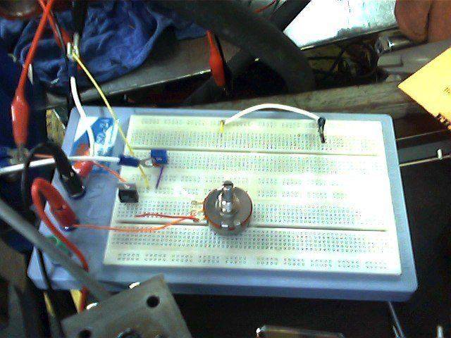

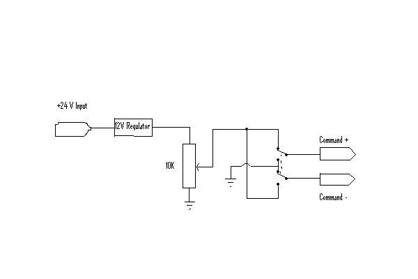

Hey, all. I've run into a real problem with my control circuit. The circuit is simple enough. I am designing a controller for a servovalve that looks something like this.
The frustrating thing is, it works in one direction, but when I flip the switch to reverse polarity, it stops working unless I turn the pot all the way open and then I get a large current draw. I don't understand at all why this is happening. Why does it work in one direction, but not the other? When I hook up a power supply directly to the switch, it works fine, but with the regulator and pot in there it starts acting funny. Help please! I've been stumped for over a day and I need to get this figured out.
Edit - I should say that I forgot to ground the regulator in the schematic. It is grounded on the breadboard, though.
You need to give the input requirement of the device you are driving to know whether your circuit is correct. But this is just my guess:
Your negative control is nothing more than the reverse of the positive control. The positive is from 0 to 12V, the negative is nothing more than from 12 to 0 V. Is that what you want, or you really want 0 to -12V control? You don't get -12V in your circuit.
The command signal is +/- 10V but it doesn't hurt anything to go a little over. The current is only a couple mA. Shouldn't the switch simply reverse the direction of the signal? Why does it only work in one direction?
I don't need "negative voltage," per se. I simply need the signal to flow in the opposite direction when I flip the switch. It works when it is connected directly to the power supply, but not when I'm using the regulator and pot. I just don't understand why it will only work one way and not when switched to reverse.

No, your circuit only provide 0 to +10V, you have no -10V capability. Look at your schematic again, That is exactly what my first post said, you just reverse the direction only, you don't get -ve voltage out of your circuit. Think about it, you flip the other way, you just reverse from 0 to +10 into +10 to 0, you don't get from 0 to -10V.

You need to put actually -10V to drive the unit, right now, your lowest voltage is 0V no matter which side you choose, you need -10V. Right now, you are only provide half the control range. You are going to need two regulators, one 10V, one -10V and then you have the range to control the circuit.
From your circuit, you only flip the direction of the control. Use the multimeter to measure the control and you see what I mean.

Hi servo. The problem is that you are switching which side of the "command" input input is grounded and which one receives the input voltage. Yes this can be the equivalent to simply reversing the the polarity but only if the command+/- inputs are strictly differential (with a common mode range of at least 12 volts). You need to conform that this is indeed the characteristics of the command+/- inputs.
The valve itself is powered by 24VDC. This 24V is what powers the servo, which is a pilot spool that moves back and forth depending on the command voltage. The command voltage is translated by a microcontroller inside the valve where it sends out the actual current to move the spool. When I supply the command voltage directly to the valve using a variable power supply, as I have been doing, it works just fine in both directions with no problems. It is only when I try to control it with the regulator/pot setup that I have trouble. Because of being able to run it off a power supply, I know that I do not need dual power. All I need is 10VDC flowing in one pin and out the other. I think what I have is a grounding issue, but I don't know where or why. I've attached my setup.

Ok so you've definitely verified that you can switch the ground connection from command- to command+ like that, then the input must be floating differential (at least within some common mode range). Make sure you haven't inadvertently added any other ground connections to command- anywhere in the circuit (other than the ONE ground connection that is made through the center point of your two switches).

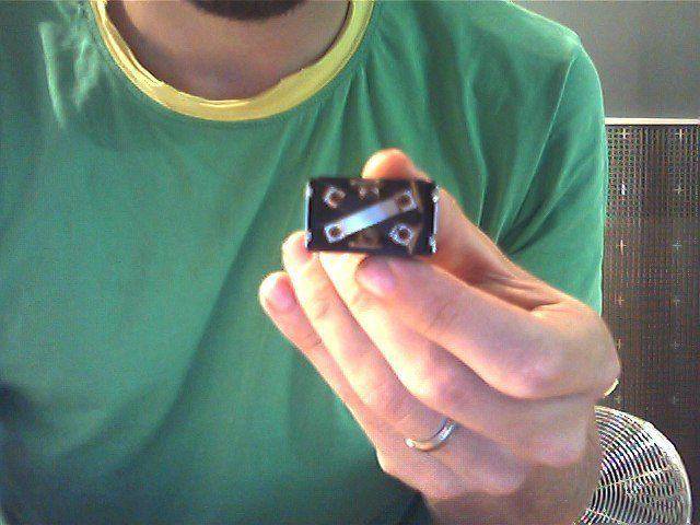

I'm only using 1 switch. It's a standard reversal switch. The pot is a 10k .5W single turn.
That's the funny thing, though. If it didn't work at all it would be easier to fix, but it works properly only when the input is command + and ground is command -. With this setup it doesn't work the other way around. It's just killing me trying to figure out why works one way, but not the other.
Everything you have written tends to indicate that you have an inadvertent ground connection somewhere on the command- input.
Can you measure the voltage applied to each input relative to ground, for each of the switch positions.
