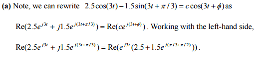

Printed problem b.10: Use Euler's identity to solve or prove the following. Part a: find real, positive constants c and φ for all real t such that 2.5 cos(3t) − 1.5 sin(3t + π/3) = c cos(3t + φ).
[/B]
Handwritten-style typeset derivation rewriting 2.5cos(3t) - 1.5sin(3t + π/3) as c cos(3t + φ) via Re(...) of complex exponentials, with the left-hand side expanded as Re(2.5e^{j3t} + j1.5e^{j(3t+π/3)}) = Re(e^{j3t}(2.5 + 1.5e^{j(π/3+π/2)}).
How are we able to go from the first line to the second line and then the second line to the third?
Euler Identity: e^j(theta) = cos(theta) +jsin(theta)
This problem is more about preliminary theory in my opinion so I tried understanding how they converted the problem from trigonometric functions to exponential by analyzing the Euler Identity.
Rewrite sin(x) and cos(x) in terms of the Euler identity, substitute in the original equation, and force equivalences.

Thank you for the response sir but I really do not see how that works. How can one simply say that 2.5cos(3t) = 2.5e^(3jt). I thought cos(theta) = 1/2(e^j(theta) + e^-j(theta)) determined by the subtraction of 2 mcclauirin series.
You can't.
Right. Use that and the similar expression for sin(theta) and combine coefficients of ej3t and e-j3t.

Oh I see! That makes a lot of sense thank you kindly.
