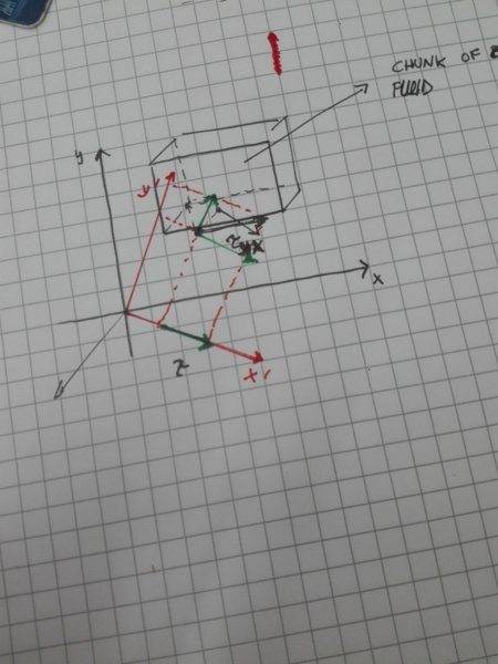

Do you mean something like this?
I think it is clear. But it is different: here you "create" the normal components by rotating the axis. Consider a chunk of fluid flowing in rectangular pipe (so we won't bother changing coordinates). Let's set the origin of the axis in one of the corner of the pipe (no rotation). What is the meaning of ##\tau_{ii}##?
Ps: I remember the Cauchy stress tensor for a rigid (static) body has to be symmetric because of conservation of momentum. Does this apply also to viscous stress tensor?

For this flow, it is zero. If you want to see the full derivation showing why the normal components can be non-zero, see chapters 1 and 2 in Transport Phenomena by Bird, Stewart, and Lightfoot
Yes.
