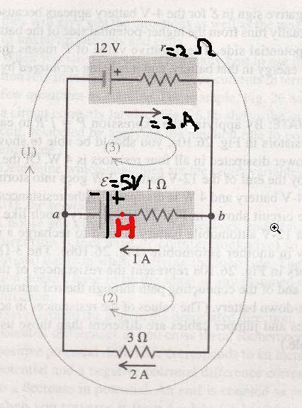

hi everyone,
please i need urgent help. in the attached image if R=1 ohm is traverse from b to H, why is potential change taken as -ive. the point H is close to +ive terminal of 5V power supply so it could also be a positive potential when traversing from b to H? please help me. hope you understand my question. in other words why is potential change taken as -(1A x 1Ohm) instead of +(1A x 1Ohm) when traversing from b to H - H being close to positive terminal of 5V power supply?
and same could be said when traversing from H to b, i think then potential change would taken as positive, why?
thanks. please help me quickly

hi painterguy! :smile:
(have an ohm: Ω and there's usually no "i" in "+ve" :wink:)
i don't really understand what you're trying to do :confused:
if you're applying KVL to the top loop, clockwise, then IR for both resistors will be +ve, though the V for one battery will be +ve, and one will be -ve
(and both batteries are "pushing" the same way, so one has to lose, doesn't it? :wink:)

hello painterguy! :smile:
(on a mac, you can just type alt-z for Ω :wink:)
it depends whether you measure it from a to b or from b to a
the potential difference clockwise around the outside loop is 6 V across each resistor, equalling the 12 V emf
but the potential difference clockwise around the lower loop is 6 V across the lowest resistor, and minus 1 V across the middle resistor, equalling the 5 V emf :wink:
