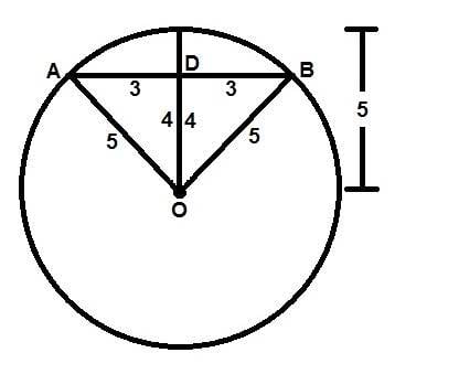

Alright I am really close to understanding it. Now I just want to see all this in action so I can actually see how you guys calculate it. I drew the circle and triangle and everything.
So can you guys show me how this formula "sin(θ/2) = AD/AO = (1/2 chordAB)/1" works out, showing how each part before the equal sign is calculated. Then how this one is done "chordAB = 2sin(θ/2)".
Here's the triangle to go by.
Thanks for helping me out with this.
Hi ISX! :smile:
You can read it straight off the diagram …
θ = AOB,
so chordAB = 2AD = 2sinAOD = 2sin(θ/2) :wink:
what is worrying you about that? :confused:
I can't figure out how it calculates out, I need to see it done on a triangle then I can figure it all out. ChordAB is 6, 2AD is 6, but the sin of AOD is 0.6 * 2 is 1.2.
oh, the radius is 5 …
the radius in the original question was 1 …
ok, divide by 5 …
sinAOD = opp/hyp = 3/5 = 0.6
chordAB = AB/5 = 1.2 = 2sinAOD :wink:
A post before this last one you said "so chordAB = 2AD = 2sinAOD = 2sin(θ/2)" and here you say "chordAB = AB/5 = 1.2 = 2sinAOD". From what I can gather, all of that is all equal. Which means 2AD equals AB/5 or 1.2. Well how does 2AD = 1.2 when line AD is 3, so 2AD is 6?
sin(AOD)=3/5=0.6 yes, but that doesn't tell us what the opposite length is.
In any right triangle, \sin\theta=\frac{opp}{hyp} so in order to find the length you're looking for (which is the opposite length), you need to multiply through by the hypotenuse length, so we have opp=hyp\cdot\sin\theta which will give you the value 3 which you're looking for.
By the way, sin(AOD) is not a length, it's a ratio between the opposite and hypotenuse sides. Since it's equal to 0.6, this means the opposite length to hypotenuse length is in a ratio of 0.6:1, or 3:5, or 3000:5000 etc. The sine of an angle doesn't tell us anything about the size of the triangle, only the ratios of the sides.
As Unrest stated, that equation is in reference to the unit circle (one with a radius of 1).
For the general circle, the equation becomes:
\text{chord} ~ \theta = 2r \sin \frac{\theta}{2}
This is basically what Mentallic was pointing out.
