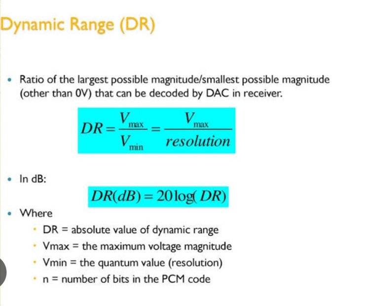

I got the derivation of the formula. It's from this:
DR = 20 Log Vmax/Vmin
DR/20 = Log Vmax/Vmin
10^(DR/20) = Vmax/Vmin
Vmin = Vmax/10^(DR/20)
so where DR = 20
Vmin=Vmax/10
This was what I was referring to that Vmin is at least 10% of Vmax. I thought this applies to white noise and sine waves too. So they can't be applied? But both ADC/DAC and pure sine wave/white noise concept have noise floor. Why can't you apply them both? Why is Vmin=Vmax/10 only for DAC/ADC?

How is this relevant? You could store the whole of Wikipedia but, if you don't actually read stuff, it's wasted effort.
In your mystery formula, you should realise that "dB" conventionally is the unit Decibel and not a symbol for a variable. It is the ratio of two powers.

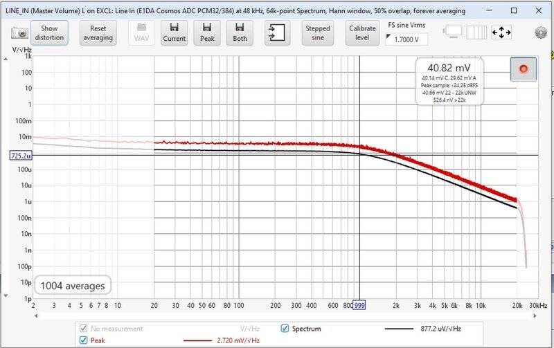

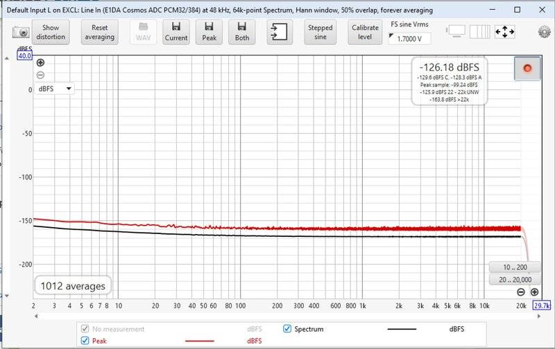

I've spent several months measuring noises of amplifiers. I used the world's 2nd quietest ADC, the E1DA Cosmos ADC with the following noise floor.
I used it for example to measure the noise floor of an amplifier with bandwidth set to 1000Hz.

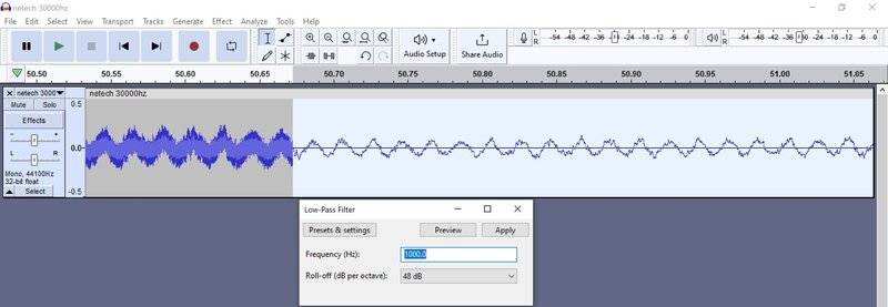

I know that as bandwidth increases, the noise increases. In the following it is originally set at 30000Hz, then I switched it to 1000Hz. Huge noises disappear. I know that noises spectrum are flat for each frequency, meaning there is equal distribution from each frequency. When I cut off above 1000Hz. Huge noises vanish.
