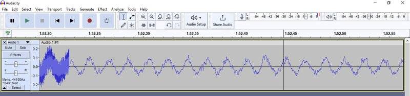

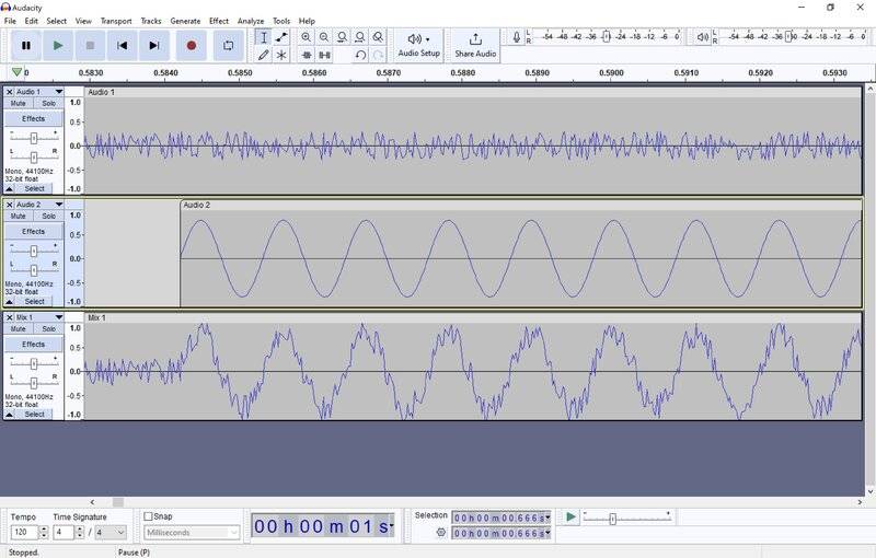

In Audacity, I was taught days after this thread was started that I could add noises in Audacity and see how they mixed up. So I was able to visualize the earlier question why 50Hz has more jagged edge vs 900Hz. .
This is 50Hz signal with 1000Hz noise.
This is 900Hz signal with 1000Hz noise.
Before I used the 1000 Hz software low pass filter in Audacity on the following 30,000 Hz signal. I didn't know what would happen. I thought if you didn't put any low pass filter on the hardware itself (like a 2nd order Butterworth filter). The noises would overwhelm the lower frequency increasing its noise. After I ran it. It became clear to me what it means the frequency spectrum of white noise is flat. And how white noise is characterized by a flat spectrum, i.e. the variance is approximately the same at all frequencies. And it is retained even after passing via an ADC. That's why you can do digital filtering like brick wall
And with your descriptions in the following. How can I not understand Noise Floor already. Of course Noise Floor doesn't mean there is a floor at the circuit where noise collects. It's like Sky is the Ceiling. There is no actual ceiling.
"The Noise we are discussing is a totally random fluctuation of a signal. Forget the sine wave ideas - that's just Maths and comes later. There is nothing in a hot resistor (or a transistor etc.) that consists of a sine wave oscillator there's just random fluctuations of charge carriers in there. When you look at a signal on a wire with an oscilloscope you will see a fuzz around the wanted signal that fuzz / grass is at a level that depends on the bandwidth that's been admitted by the input filter. "

Oh. I couldn't edit the above message anymore. In the attachments I forgot to delete. The 3rd image is the white noise not yet filtered to 1000Hz, so it is still causing jagged edge even to 900Hz signal. Also the noise amplitude is just 0.3 while the sine wave is 0.8.
The noise and sine amplitude should be the same in the simulation, isn't it? The maximum is 1.0 but I used 0.8 to show the baseline better. I should have used 1.0 maximum amplitude white noise in the noise generator?
In the following I used 0.8 Noise with half right filtered to 1000Hz noise and a 50Hz signal
In the following I used 0.8 amplitude Noise with half right filtered to 1000Hz noise and a 900Hz signal.
Why do I share them? because it was when I saw them that I totally understand and visualize the reasons for jagged edges. You can let newbies try the Audacity noise generators who may not understand too.
About probing the noise floor using FFT. It is possible that many who didn't intend to probe the noise floor and using FFT just to view the signal above noise floor can unintentionally get signal from below the noise floor, is this right?
I need to know because if you show signals you acquired and didn't say some signal was below the noise floor. People who want to duplicate your result may only focus above the noise floor.
Also what would happen if you don't use FFT but just use Power Spectral Density analysis on the noises. Would you also be able to probe below the noise floor using PSD? This is my last question.
About my experiments to duplicate one done by a university. If I can't replicate it and it is faulty. Then the prospect of Particle Dessert for the next centuries is a possibility. But if I can replicate it. I'll share far and wide the findings of the University and all resources of CERN must be re-orient to the discovery instead of no major discoveries besides the Higgs. I'll update on the result months from now if I'm still here. I can't share the source now because it is not peer reviewed and may attract the wrath of the moderators. If I found sigma 5 results. I'll try to write or make other write a paper that can be peer reviewed and share here.
