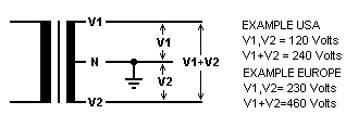

looking for someone that can explain to me the phase shift on a single phase 240v system. I just read in a book that the phases in a TWO phase system are 180 degrees out of phase from each other. i guess i have misunderstood this for years. i always thought that the phases in a single phase system were 180 degrees out of phase. i never really researched two phase since it is not really used.

I am saying "phases" because there are 2 hots and a neutral coming into your house. "Single" phase right? Each hot is 120v to neutral or ground. 240v between hots. Same results you would get with a "TWO" phase system. "TWO"phase makes complete sense, but how is it possible to get the same result with only one phase. I think a picture on an oscilloscope would really clear things up. Anyone know of any links online?

There is only one phase that is split by using a center tap ground on the secondary of a transformer as shown below (Fig. 1).
A transformer supplying a 3-wire distribution system has a single-phase input (primary) winding. The output (secondary) winding is center-tapped and the center tap connected to a grounded neutral. This 3-wire system is common in countries with a standard phase-neutral voltage of 120 V. In this case, the transformer voltage is 120 V on either side of the center tap, giving 240 V between the two live conductors, shown as V1 and V2 in Fig. 1. The two outputs are properly called "legs", not "phases".

So would I be correct in saying that the "LEGS" of a single (split) phase sys. and the "PHASES" of a two phase sys. are both 180° apart and oppisite in polarity? ultimately the same when you compare them on an oscilloscope?
No.
Two-phase electrical power was an early 20th century polyphase alternating current electric power distribution system. Two circuits were used, with voltage phases differing by 90 degrees. Usually circuits used four wires, two for each phase.
Bold by me.
http://en.wikipedia.org/wiki/2_phase_power
Digoff has it -- your house is fed with SINGLE PHASE , center-tapped.
to call the two hot wires "phases" is misleading as it infers a multiple phase system, which it really isn't.

Thanks a lot dlgoff. That wiki picture really helped. I've never seen the sine waves of a two phase sys. And I always thought the phases(of any system) had to add up to 360° I guess I need to look up single and three phase alternators now. Thanks again
