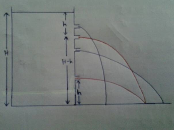

1. I found this diagram on book but there weren't any description.can someone tell me, what its trying to tell specially by those two red lines meeting the ground at the same place...?

The first question would be asking which pair of colored arcs accurately represent the path of water pouring out of that structure.

Well, I guess it is just trying to tell you about the water flow. There doesn't seem to be anything aphysical about the diagram at least at first glance and without making any measurements or calculations. The two red lines indicate that the water flow from points symmetrically placed about the center will hit the ground at the same location.
Yes...so what's the physics behind that ? water drains from symetrically placed holes from the center will catch the ground at the same place...?
russ_watters said:
The first question would be asking which pair of colored arcs accurately represent the path of water pouring out of the structure
all arcs are paths of water pouring.red color shows some special feature..
