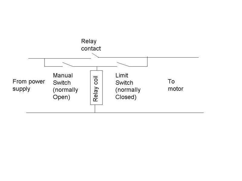

You could make a start/stop circuit like what is used for motor starters. Once the start switch is pressed, it energies a relay that has a set of contacts in parallel with it that "seals" it until a stop switch (probably a micro switch in this case) that is in series with the stop switch is opened. Check out the Motor Starter Animation diagram at the end of this page. All you are concerned with is the start-stop portion of this operation.

I am very sorry to hear about your wife. Here in thumbnail is a simple latching relay circuit. The manual switch is normally open, and will supply power to the relay when it is closed. The limit switch is normally closed, and will continue to supply power to the relay until it opens. I hope this helps.

Just parallel the relay contacts with your momentary Manual Switch and you have the motor starter circuit I was suggesting.
For my post #3 with the latching relay circuit, note
1) Pressing the momentary manual switch in my tumbnail sketch will override the limit switch and permit non-latching contol beyond the limit. If you want to prevent manual override, then [STRIKE]another pole of the same limit switch should be between the manual switch and the relay coil[/STRIKE] move the limit switch downstream to the far right side of the circuit diagram, between the latching curcuit and the motor.
2) If you want a bi-diectional system, then you will need two separate latching relay circuits, one for each direction (there may be other ways), each using limit switches on separate ends. In this case, the arm can be moved in either direction between the limits, using separate manual switches.
3) For a bi-directional system, a separate pole of one of the latching relays will need to operate a downstream DPDT polarity reversing relay to change voltage polarity on the motor.

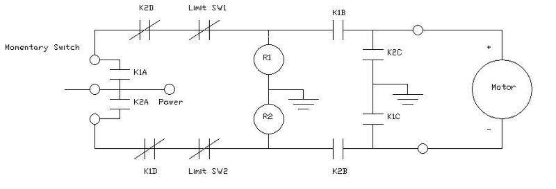

This is how I would do it. I don't see that you would need latching relays. Note that K1A, K1B,and K1C are relay contacts for relay R1 and similarly for R2 relay. The limit switches are for both ends of the arms travel.
Edit: As wired, you would not want to press the return until the cup has reached its limit switch and has opened the circuit. Might require some safety feature to prevent accidental switching before travel is complete.

The relay contacts across the momentary switch seals the switch so no latching relays are required. i.e. the K1A or K2A contacts.

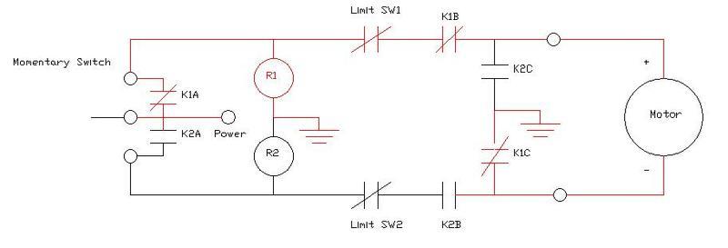

Here is the circuit current path with red showing the "moving of the cup forward".

I agree, but it looks like if the direction of motion were changed, both K1A and K2A would be closed and both relay coils R1 and R2 would be energized at the same time.

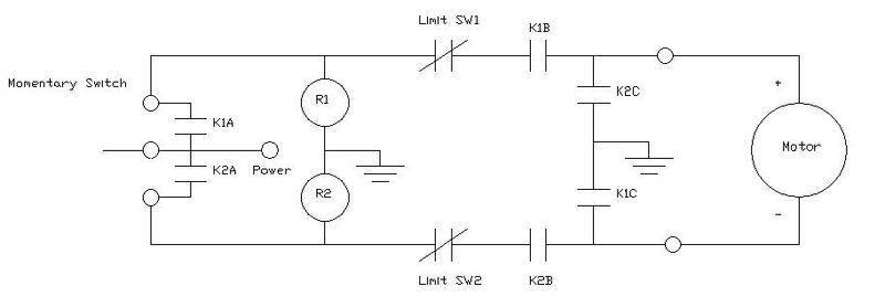

That's why I put in
[STRIKE]One would need to put in another set of contacts to remove the momentary switch common terminal from power after the sealing relay has "made up". Maybe another relay?[/STRIKE] Here's how to take care of it. The relays will need 3 normally open and 1 normally close set of contacts. The normally closed ones are used to disable the momentary switch until the limit switches are opened.
Edit: Changed drawing. The limit switches need to be before the relay coil and the normally closed contacts should have been K1D and K2D.
