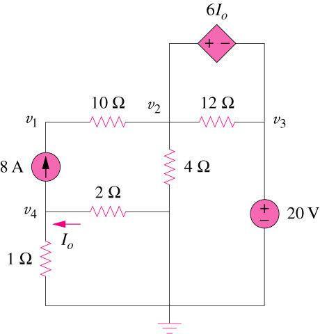

fdsaman Messages 1 Reaction score 0 Thread starter Oct 9, 2007 #1 Homework Statement can anyone tell me the way to caculate the v1, v2 and v3 shown in the picture?thankyou >< Homework Equations v1, v2 and v3. The Attempt at a Solution
berkeman Admin Messages 69,677 Reaction score 25,416 Oct 9, 2007 #2 I would use the Kirchoff Current Law (KCL -- the sum of all currents out of a particular node is equal to zero). Write the KCL equations for all of the nodes in the circuit, and then solve those simultaneous equations for the unknown voltages.
