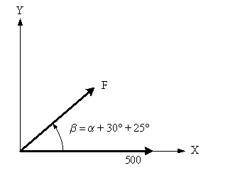

Sometimes a change of axes can make things dramatically easier. Align your positive X-axis through the 500N force. That eliminates dealing with any y-components for that vector. Your method of combining the two other forces into one with an angular offset is excellent. Add that to the mix. Then you get a situation that looks like this:
Vector diagram with X and Y axes; a force F points up and to the right, and a 500 arrow lies along the positive X axis. The angle beta = alpha + 30° + 25° is marked between them.
Another hint: scale the problem so that the length of the vector F becomes 1. That is, divide both vectors by |F|. Note that angles are in no way affected by a change of scale.
  • Vector diagram with X and Y axes, a force F drawn at angle beta from the X axis, and a 500 horizontal vector along the X axis; beta = alpha + 30 degrees + 25 degrees.

mm, okay I followed your procedure, and I was able to get 27.47 as the angle for which gives 600N like this:
setting x = alpha + 55
sum of y-axis = sin x
sum of x-axis = cos x + 1.838
600/272 = 2.20
so, 2.20^2 = sin^2 x + cos^2 + 1.838^2 + 2*1.838*cos x
it simplifies to 0.131054 = cos (x)
and after substitution, i will find alpha is 27.47. I double checked this degree and was able to get 600N as the resultant force, which is great. Now getting the angle for lowest R,
R^2 - 4.378 = 3.676cos x, looking at this expression. I know that R can't be zero. Am I supposed to derive R = sqrt(4.378 + 3.676cos x), and set DR/Dx to zero and solve for x?? the derivative that wolframalpha gives me doesn't look too friendly. :S
Too complicated! :smile:
There are two angles that will satisfy cos(x) = <something>. What's the other one?
Okay, so, I can do arccos (0.131054) = 82.47, but the other angle that would also satisfy this would be -82.47, or 277.53, now substracting 55, i would get 222.53 for alpha. This 222.53 would result in a resultant vector of 600N, but how do i know, in between 27.47 to 222.53, the resultant vector is under 600N? I mean , we only found the points where the resultant vector would 600N.

If a function f(x) has two zero crossings with no other crossings in between, there are only two possibilities for the sign of the values of f(x) between those crossings: either they're all positive or they're all negative. Test an angle in between your solution values to see which portion of the full circle encompasses your solution set.
right! I remember that theorem from calculus I, thank you so much! I appreciate the help a lot. :)
