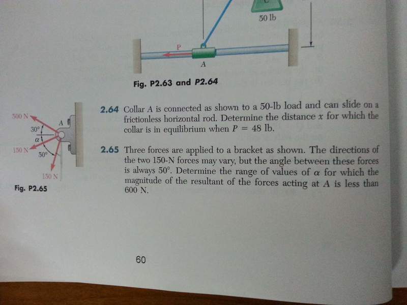

So I have a mechanics question 2.65 of which I have deduced the following :
[tex]x-Component of all forces[/tex]
[tex]F1 = 150 cos30[/tex]
[tex]F2= 150 cos \alpha[/tex]
[tex]F3 = 150 cos(\alpha+50)[/tex]
[tex]y-Components of all forces[/tex]
[tex]F1 = -150 sin30[/tex]
[tex]F2 = 150 sin \alpha[/tex]
[tex]F3 = 150 cos(50-\alpha)[/tex]
Finally, [tex]R = \sqrt{(\Sigma Fx)^2 + (\Sigma Fy)^2}[/tex]
Now we know the resultant is at max 600 N, how do we go about solving [tex]\alpha[/tex] ? I tried applying various trig formulas like angle addition and subtraction, but I couldn't isolate [tex]\alpha[/tex]. How would you go about solving for alpha?
