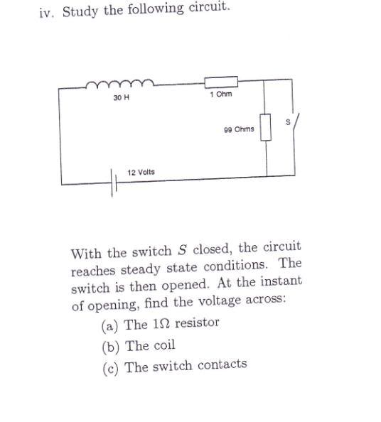

Circuit schematic: a 30 H inductor, a 12 Volts battery, a 1 Ohm resistor, a 99 Ohms resistor, and a switch labelled S in a single loop, with the prompt about voltages at the instant S is opened.
H= (NI)/ (2(Pi)r)
V=IR
a)
total resitance = 100ohms?
from this would the current be 0.12A
over 1ohm resistor: 0.12V
not sure if this is correct even. Any help would be much appreciated.
  • Circuit schematic with a 30 H inductor, 12 Volts source, 1 Ohm resistor, 99 Ohms resistor, and switch S in parallel with the 99 Ohms resistor; above it the text: With the switch S closed, the circuit reaches steady state conditions.
I think you misread 'H' here. H in the question doesn't refer to the magnetic field strength and the formula you provided here refers to the H-field in a torus.
