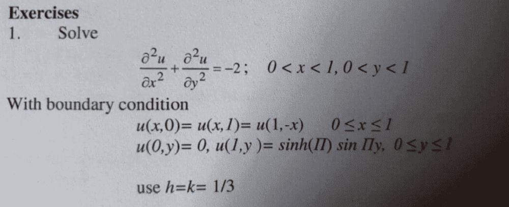

solve the inhomogenous pde below by considering the boundary conditions given
separation of variables.
ial
this is the question.

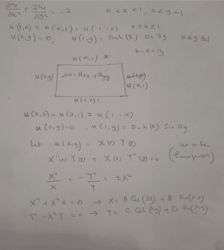

its very long since i solved such questions during my post graduate class, i am trying to see if i can remember...
i attempted to solve the homogenous part, i just want to know if i am on the right track...
am i thinking right or i am missing something...from literature i can see that this does not qualify to be solved by the approach i have used of trying to solve homogenous pde...breaking them into ode. Since we have ##-2## on the rhs then it becomes poisson equation?
As with any linear problem the answer is "take something which satisfies the RHS and add something from the kernel".
So here: Find a function of (x,y) which satisfies [itex]\nabla^2 f = -2[/itex] and add solutions of Laplace's equation to satisfy the boundary condition. This is easier if your particular solution satisfies as much of the boundary condition as possible. Here I think you have less work if your function vanishes on [itex]x = 0[/itex] and [itex]x = 1[/itex].
Here you have [itex]u(x,0) = u(x,1) = u(1,-x) = -\sinh \pi \sin(\pi x)[/itex].
Don't forget that you can use [itex]\cosh (kx)[/itex] and [itex]\sinh(kx)[/itex] in place of [itex]e^{\pm kx}[/itex] and that [itex]\sinh(k(1 - x))[/itex] is a linear combination of these.

* Am on this now...allow me to deal with it slowly...am now conversant with pde's. This is Laplace equation...steady-state equation (Equilibrium solution).
We shall solve this by separation of variables, we shall seek solutions of the form:
##U(x,y) = X(x) Y(y)##
For the Homogenous part we shall have;
##X^{''}(x) Y(y) + X(x) Y^{''} (y) = 0##
it follows that,
##\dfrac{X^{''}(x)}{X(x)} = -\dfrac{Y^{''}(y)}{Y(y)} =±μ^2##
case 1; using eigenvalue ##[λ=μ^2]##
##X^{''} -μ^2X=0##
##Y^{''}+μ^2Y=0##
##X^{''} -μ^2X=0##
it follows that
##m^2-μ^2=0## is our characteristic equation, solving we get;
##m^2=μ^2##
##⇒m=\sqrt{μ^2}=μ## our solution would therefore be of the form;
##X=e^{μx}=A \cosh μx +B \sinh μx##
##X=A \cosh μx +B \sinh μx##
...will continue later.
Solution
[tex] u(x,y) = x(1-x) - \sum_{n=1}^\infty Y_n(y) a_n \sin (n \pi x) + \sinh(\pi x)\sin(\pi y) <br /> - ( \sinh (\pi y) + \sinh (\pi(1 - y)) )\sin (\pi x)[/tex] where [tex] Y_n(y) = \frac{\sinh(n\pi y) + \sinh(n\pi(1-y))}{\sinh (n \pi)}[/tex] is chosen such that [itex]Y_n(0) = Y_n(1) = 1[/itex] and [tex] \sum_{n=1}^\infty a_n \sin (n \pi x) = x(1-x).[/tex]
