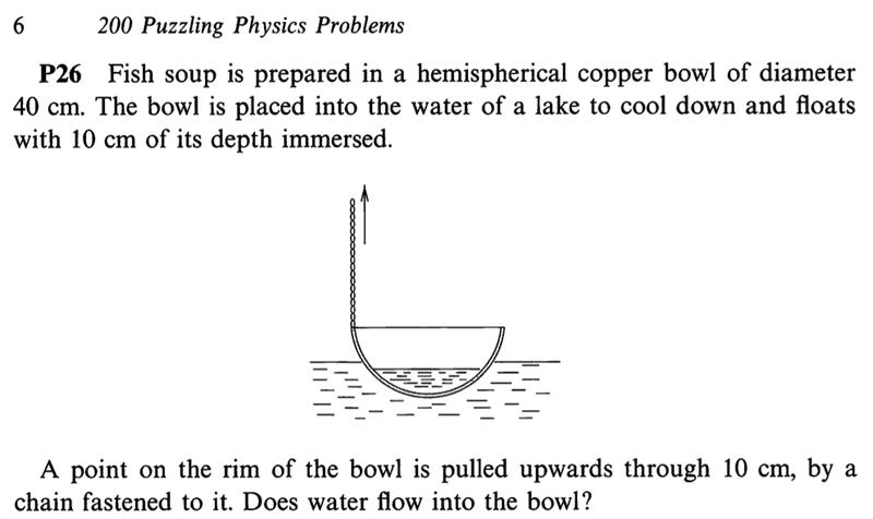

So I've been trying to do some physics puzzles and I've come across this in a book called "200 puzzling physics problems." The solution in the back makes no sense to me and I can't seem to figure it out by myself. Can anyone help me?

Really? You reckon that would be true if the diameter of the bowl is 11cm ? This is a chain pulling it up, not a welded solid handle

That solution on the back makes no sense linguistically. Here is my thinking: In the worst case scenario the bowl would be turning around the center of the circle it is a half of. Since the left most point on the bowl goes up by 10cm the right most point must go down 10cm, and this is exactly the boundary point for water spilling in. However, since the chain is applying an upward force on the bowl, the buoyant force would cause the entire bowl to move upwards. Thus the rotation of the bowl around its center only partially contributes to the leftmost point's moving upwards, and the rest is due to the buoyant force. Thus water will not flow in.

Your thinking is exactly what I came up with. The only way to reach water level on the low side is if the bowl has zero mass, and no such specification was made in the problem statement.
I googled 200 puzzling physics problems pdf and the second link goes to a complete pdf of the book. I don't know if it is allowed to post a link due to copyright issues.
Well, the correct solution is, as I expected, what c++guru said. You can find it in page 85 if you find the pdf. I do not see any problem with the solution, it makes sense.
The bowl is made of copper, so it's denser than the water, and it contains fish soup, which is safe to assume that has approximately the same density as water. Therefore we can ascertain that the level of the soup must be below the lake’s level. Both the buoyant force and the soup’s weight are vertical forces that go through the sphere's geometrical centre. But the centre of mass of the bowl is below the hemisphere’s geometrical centre, so the system acts as a pendulum.
In order to tilt the hemispherical bowl the chain has to exert an upwards force on the rim, this will lift the bowl, thus preventing the water to go over the bowl’s rim.
