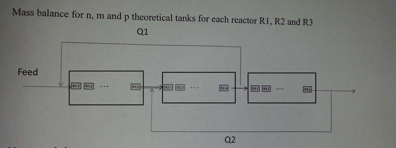

The background of this problem is indeed as you mentioned some sort fo delayed concentration. It is actually a three tank system with recirculation streams from the second to the first and from the third to the second tank. The V constancts represent the volume of the respective tanks, whilst the A,B,.. constants are values for the flow rates. The number of equations n,m and p represent the theoretical tanks for each actual tank.
This diagram should give a better representation of the problem.
Flow diagram of three reactor tanks in series: feed enters R1.1, R1.2 ... R1.n, then R2.1, R2.2 ... R2.m, then R3.1, R3.2 ... R3.p, with recycle streams Q1 and Q2.
Unfortunately I am not as experienced with math as I would like. As the sequence of equtions I have always contain at least 2 variables I don't see a straight forward substitution, but than again i am far from a mattamatician. I work as a consultant process engineer...

This tanks-in-series problem with recycles would typically have to be solved numerically. I assume that the C's are concentrations. I also assume, as implied by your problem formulation that there are no chemical reactions occurring. Is that correct? The way to solve a problem like this numerically is to define a solution vector y = C11,...,C1n,C21,...,C2m,C31,...,C3p. Then express the differential equation in the form
dy/dt = M y
where M is a matrix of constant coefficients. You then solve this set of m+n+p first order linear ODEs in m+n+p unknowns, subject to your specified initial conditions using an automatic ODE solver, preferably one with a stiff equation option, such as the GEAR package.
