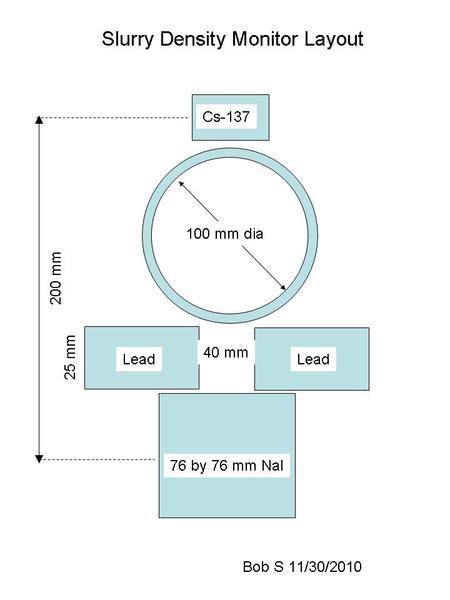

My general concept of the Cs-137 NaI(Tl) layout is shown in the thumbnail. The Cs-137 source is above the slurry pipe. Directly below the pipe is a lead aperture to restrict the width of the beam to 40 mm, so as to limit gammas from thinner parts of the slurry pipe. This is a rectangular aperture, 40 mm by 75 mm. Below the lead is a 3" by 3" NaI(Tl) integrated scintillator photomultiplier PMT base assembly. It will have two connections: 1) negative high voltage input, and 2) analog negative polarity pulse output.
How long are the cables from this assembly to the electronics?

You would read the sum counts output on a LED display at the end of a 1 minute run. An alternate is to use an analog ratemeter like the model 661 ratemeter in the Ortec list (click on model number to see enlarged picture and data sheet). This analog meter readout will have an overall accuracy of ≈5%.
The minimum source size without the lead aperture is about 20 μCi. With the lead aperture, increase to 40 μCi. If the final separation is more than 200 mm, increase source strength by the square of the distance ratio. You could easily order a 100 μCi source which will cover all uncertainties. At this time with the 100 mm pipe, a 1 mCi source is overkill. If you have radiation safety agencies in your country, they will recommend that you stay several meters away. As I recall, 25 mm of lead will reduce the gamma radiation by a factor of 10. i suspect they will recommend about 100 mm of lead around the source.

I forgot to tell you that i have to place the density gauge parallel to the pipe(not above the pipe). This is because my slurry is inside a horizontal rotating wheel tube. Then, can i use the same layout or does it change the specs?
I live in Canada. Just to be clear to myself, are you recommending a lead shielding (of 100mm) around the source in addition to the lead aperture?
Since my wheel tube is rotating, i can't clamp anything to it. So does your recommended layout still work?
You can mount the assembly either vertically or horizontally. I didn't use lead shielding when I was young. But we live in a different world now. Somebody in your province will regulate what you can do. Do you have any preference for the suppliers? Do you live near any national labs, like TRIUMF, Chalk River, etc.?

I need not worry too much about the suppliers, as my boss will take care of it. I just need to give him the specs . Since my wheel tube is rotating, i can't mount the assembly on the tube. So does your recommended layout still work?
Yes, leave ≈ 10 mm clearance on each side. You don't want to bump either the Cs-137 source or the NaI(Tl) crystal.
