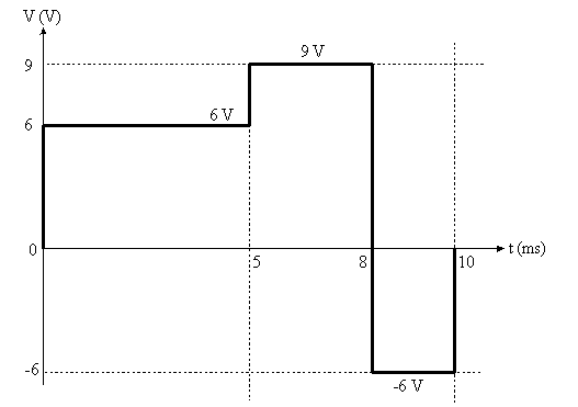

I would like to ask a question from the 2nd screenshot. "Determine the effective (r.m.s) value of this voltage waveform over one complete cycle.
I don't know how to solve this part. Is the 1st screenshot question which I got the answer the same method as the 2nd ?
I would appreciate if someone can give some guidance to me, thanks.

Ok. so for the 2nd question, since I'm not given an expression and the waveform is not sinusoidal, do i need to work out an expression for myself and from there mutiply by √2?Omg how do i write an expression that is not sinusoidal o_0
Note that the constant factor √2 applies to the relationship between peak and rms for sinusoids. It does not so apply for arbitrary waveforms.
You should apply the definition of RMS to the given waveform.
Do you mean that the concept of x √2 or / √2 does not apply to this question because it is not a sin wave form?
If yes how do i find the rms value for square wave form?
Yes, that's right.
Apply the definition of RMS. The name gives a hint on how to remember what to do; it's the square Root of the Mean of the Square value of the function over its period.
$$f_{rms} = \sqrt{\frac{1}{T}\int_0^T f(t)^2 dt}$$
Since your voltage signal is comprised of several constant values over the period of 10ms, you can break the sum of the squares into a few pieces that are easy to do by inspection.

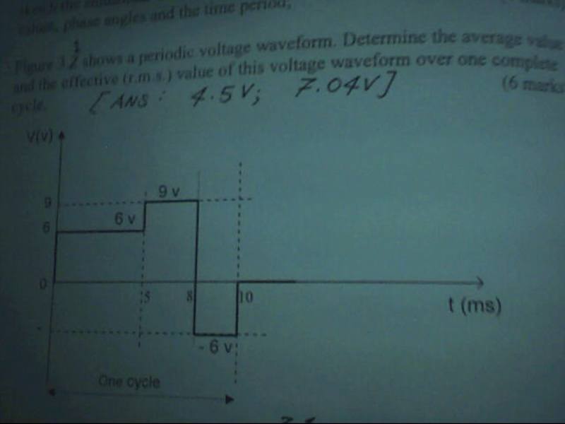

In your attachment showing the voltage waveform over a period the first portion of the period shows a value of 6V for a time of 5ms. Dropping the units for now, integrating the square over that portion of the curve yields (6)2x5 = 180. Do the same for the rest of the segments and sum the results. Take the mean by dividing the sum by the whole period (10).
Before I go on to find the rms value, can you help me check the answer for part vii.
My working for area:
(6x5)+(9x3)+(-6x2)=45
Average value:
45/10=4.5v (Ans)
Average value:
45/10=4.5v (Ans)
Sure, looks good.

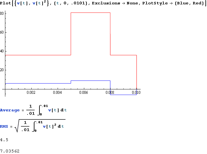

Here is the v(t) and v(t)^2 plot. The v(t) is blue and v(t)^2 is red.
Also shown is the calculation of the average and the RMS value.
