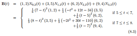

Hi all,
The control points are five and they are:
b0 = (0,0)
b1 = (1,3)
b2 = (3,0)
b3 = (4,3)
b4 = (6,0)
The degree d is 2.
The number of knots t are 8 and they are:
t0 = 0
t1 = 1
t2 = 2
t3 = 3
t4 = 4
t5 = 5
t6 = 6
t7 = 7
What is the next step to solve this b-spline?
Thank you

Step 1: define your ##N_{i,0}## basis functions.
Step 2: define your ##N_{i,1}## basis functions in terms of your ##N_{i,0}## basis functions.
Step 3: define your ##N_{i,2}## basis functions in terms of your ##N_{i,1}## basis functions.
Step 4: sum them up to make your ##\mathbf{B}## spline.
If you are comfortable with linear algebra, this looks like something a computer would do a lot faster.

First, define all your ##N_{i,0}## functions. Notice that these are only non-zero over the single unit ##[t_i,t_{i+1}]## and on that unit they are 1.
Then, define your ##N_{i,1}## functions.
For example, ##N_{0,1} =\frac{t-0}{1-0}N_{0,0}+\frac{2-t}{2-1}N_{1,0}=t \text{ on }[0,1), = 2-t \text{ on }[1,2)##.
Notice that these are continuous linear functions interpolating your points.
Also, ##N_{1,1} =\frac{t-1}{2-1}N_{1,0}+\frac{3-t}{3-2}N_{2,0}=t-1 \text{ on }[1,2), = 3-t \text{ on }[2,3)##.
Moving on the the ##N_{i,2} ## quadratic basis functions, you have:
##N_{0,2} =\frac{t-0}{2-0}N_{0,1}+\frac{3-t}{3-1}N_{1,1}=\frac{t^2}{2} \text{ on }[0,1), = \frac{2t-t^2}{2}+\frac{(3-t)^2}{2} \text{ on }[1,2)##.
If you are doing this with a computer, it should be much faster than doing it by hand.
Just pay attention to where the functions are non-zero and sum the pieces appropriately.
Why ##\frac{1}{6}(7-t)^2(1,2)+\frac{1}{3}(-t^2+12t-34)(3,5)+\frac{1}{6}(t-5)^2(6,2)## on ##5≤t<7##?

All the functions should be equal at the nodes, so it is just a matter of only defining each point once. Though for implementation it doesn't impact the method.
I am sorry but I still do not understand. Please use a basic english which is easy to understand as english is not my native language.
Why chose 5 <= t < 7 and 7 <= t < 8 (see the image below) for the final step?
It does not matter. Both should be equal at t=7.
RUber said:
It does not matter.
What is does not matter?
Why?
Does not matter means the result will be te same either way.
A spline is designed to be a continuous function. If they were different at t=7, it would not be continuous.
In any case, if you find it easier to define the point by the right function rather than the left, there should be no problems.
Why the final answer is 5 <= t < 7 and 7 <= t <= 8?
Reading definition 8.2 in the material posted above, it says that the final answer will be defined from ##t_d## to ##t_{n-d}##.
Since in this example (8.3), d=2, your interval for the spline will be from ##t_2## to ##t_{6-2}##, which covers the points 5, 7, and 8.
Was this the heart of your misunderstanding?
