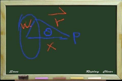

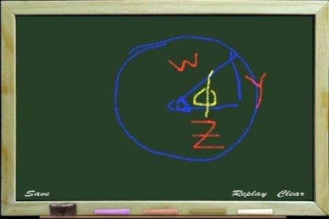

This is a simple problem if you work with only magnitude and consider the symmetry of a ring. However, I am taking a detailed approach, and I am not getting the correct answer. Could you please look over my math?
a evenly distributed ring of charge on the positive Y-Z plane has a current, I, flowing counterclockwise or flowing from positive Z direction on top and -Z direction on bottom of ring. Figure out the magnetic field along the X axis of this ring of charge from the center of the ring.
[tex]d \vec{B} = \frac {\mu_{o} I}{4\pi} \frac {d\vec{l} \times \hat{r}}{r^2}[/tex]
below are pictures of the ring of charge. left picture is the sideway view with theta being constant. right picture is the frontal view with phi.
[tex]d\vec{l} = <0 , dl cos\phi , dl sin\phi>[/tex]
[tex]\hat{r} = <cos\theta , -w/r sin\phi , w/r cos\phi>[/tex]
[tex]{d\vec{l} \times \hat{r} = \frac{w}{r} cos^2\phi dl \cdot \hat{i} + \frac{w}{r} sin^2\phi dl \cdot \hat{i} + cos\theta sin\phi dl \cdot \hat{j} - cos\theta cos\phi dl \cdot \hat{k}[/tex]
[tex]\frac {d\vec{l} \times \hat{r}}{r^2} =\frac{w}{r^3} 1 dl \cdot \hat{i} +\frac{1}{r^2} cos\theta sin\phi dl \cdot \hat{j} - \frac{1}{r^2} cos\theta cos\phi dl \cdot \hat{k}[/tex]
[tex]dl = w d\phi[/tex]
[tex]\frac {d\vec{l} \times \hat{r}}{r^2} = \frac{w^2}{r^3} 1 d\phi \cdot \hat{i} +\frac{w}{r^2} cos\theta sin\phi d\phi \cdot \hat{j} - \frac{w}{r^2} cos\theta cos\phi d\phi \cdot \hat{k}[/tex]

z plane refers to the z-y plane. w is the radius of the ring of charge. positive z direction current on top of ring and negative z direction current on bottom of ring (counterclockwise current flow)

[itex]d\vec{l}[/itex] is an infinitesimal piece of the ring, right? If the ring is entirely in the y-z plane, why does your expression have a non-zero x-coordinate?
Are you sure about the sign of the z-coordinate?
Also, I'm not sure why you would bother introducing a new variable [itex]\theta[/itex] here...why not just work with the variables given ion the problem statement [itex]x[/itex] and [itex]w[/itex]?
[tex]\vec{r}=<x,-w\sin\phi,-w\cos\phi>[/tex]
[tex]\implies r=\sqrt{x^2+w^2}[/tex]
[tex]\implies\hat{r}=<\frac{x}{\sqrt{x^2+w^2}},\frac{-w\sin\phi}{\sqrt{x^2+w^2}},\frac{-w\cos\phi}{\sqrt{x^2+w^2}}>[/tex]

Yes, I realized after I posted that [itex]\cos^2\theta+\frac{w^2}{r^2}=1[/itex] from looking at your picture.
okay...it's been corrected...i'll check back in a couple of hours...need to be away from computer
Hmmm... looking at your picture it seems that you have defined [itex]\phi[/itex] such that [itex]z=w\cos\phi[/itex], but looking at you calculations it seems as though you are using [itex]z=-w\cos\phi[/itex]...which is it?
i got it...came out correctly...
thank you!
