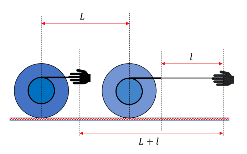

I was saying toss it for figuring out how far the hand is displaced for their question (d). Its making @Callumnc1 confused. They think the hand is only moving a distance ##L## because of how the diagram makes it appear. Arguably, they are not digesting the problem correctly, but that diagram is not helping in that department. The artist should have made the rope a bit shorter IMO.
kuruman said:
Yes, the drawing is misleading in that regard and contradicts the statement of the problem which points out that the distance by which the hand moves is “different from L”. There must have been some loss of signal from the author to the illustrator to the proofreader.
erobz said:
I would have just preferred the hand was not at ( or indistinguishably near) where they have labeled the length ##L##. Based on their answers, it seems like it's the source of their confusion.
Thank you for your replies @erobz, @kuruman and @haruspex !
haruspex said:
Not really. It shows a before and after position for the cylinder, and the distance between them is labelled L. Only one position is shown for the hand, so there is no indication of how far the hand moves.
Yes, it would have been clearer to show the after position of the hand as well, at a distance visibly greater than L.

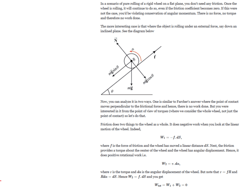

Sorry, I don't understand yet. So I understand that the friction produces a clockwise torque about the CM as with the tension. Maybe I should try to understand the origin of the static friction force. So at the moment when the cylinder is pulled by a tension force T, at the point of contact with the ground, the force of static friction oppose the relative motion by exert a force ##F_s## to the left which stops the point of contact translating with respect to the ground and allows the cylinder to roll.
I think the thing I don't understand it how the point of application of the static friction force dose not move and therefore has no displacement so not work is done (That is my textbooks explanation).
I did find this on Physics SE https://physics.stackexchange.com/q...n-friction-do-no-work-in-case-of-pure-rolling
So it looks like there are two ways analyzing the situation.
The first looks purely at the point of contact. It appears that actually the point of contact dose moves with respect to the surface, but perpendicular to the force as shown below.
Therefore, as the point of application moves perpendicular for the differential time ##dt## that static friction for is acting on the point, then the work done is ##dW = F_s~\dot~\vec {ds} = -F_s\hat {i}~\dot~ds\hat j = 0 ##
Many thanks!

We consider the point of contact to be instantaneously at rest. Although the points of contact change as the wheel rolls along, "while" in contact with the surface they have no velocity, thus no displacement.

##W_{net} = (T\hat j - F_f\hat i) \cdot [(r+\frac I{mr})\theta\hat i]##
However, this means that friction contributes to the net work done by the cylinder?
It should not from this?
Many thanks!

How does the net force not contribute to the net work? The net work is made up of the net force x displacement of the object under the net force correct? This means that object if the friction force dose indeed do no work on the cylinder then it should cancel in the net work equation, correct?
But from that equation the force of friction dose negative work.
Are you suggesting that I just have ##F_{net} = T## (which is what the textbook did) instead of ##F_{net} = T - F_f##in the net work equation, but this would not be true since if we are trying to find the net work of the entire object then we have to include all the forces acting on the total displacement of the object, correct?
Here is the net work equation I am talking about ##W_{net} = F_{net}dcos\theta##
Where d is the total displacement of the object under the net force
Many thanks!

Oh is the net work equation only valid for point particles not a rigid object like a cyclinder? Is it possible to apply it to the cyclinder correctly?
Many thanks!
