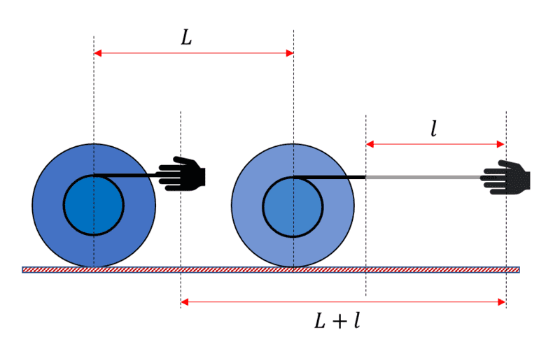

@Callumnc1
Look, you have to take a minute to draw a diagram if you are going to learn to physics...

Thank you very much for your diagram @erobz !
That is very helpful :) I was not quite sure how to go about drawing the diagram

Well, it's something that take some practice...If you're not even going to try, stumble, and maybe fail... you aren't going to get better at it. Sometimes a picture is worth a thousand words. This thread kind of proves that point.

Thank you for your reply @erobz !
I agree with everything you said, I will try to draw a diagram next time. Perhaps I should draw my own diagram for the spool?

Almost always there is a useful diagram that can be drawn for a problem.

I guess it makes sense intuitively that the distance the hand has moved with respect to the ground is the distance moved by the CM (L) + the amount of string unraveled (l)
