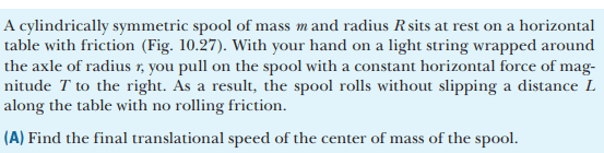

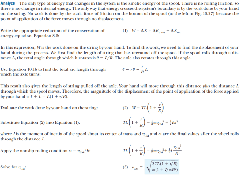

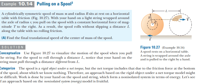

For this problem,
I have a few confusions:
(a): Why can't we use the UAM equations? Is it because the spool cannot be approximated as a point particle as it is cylinder not a sphere?
(b): I don't understand their statement about that the point of application of the force of static friction dose not move though a displacement so dose no work. To me it looks like it the point of application of static friction moves though almost the same displacement as the point of application of tension (apart from the fact they are different distances from the AoR)
(c): Why do they not include the force of friction in the net work energy theorem statement? I thought that ##W = F_{net} \times \vec r## and you don't have to take into account whether each force acting on the object is part of what causes the displacement. It seems like they did not take into account the static friction for in their energy statement even though it is a force making up the net force acting on the spool
(d) Is there a way to prove that the hand dose indeed move a distance ##l + L##?
Many thanks!

May I suggest explaining it in the reference frame of the cylinder? How far does the hand move away from the cylinder, and how far does the original position of the cylinder move in the other direction?
erobz said:
What does this mean. What amount of rope is between the drum and the hand after the COM moves a distance ##L##?
Thank you for your replies @erobz and @haruspex !
In the reference frame attached to the cylinder I will analyze how far the hand has moved away when the cylinder has rotated with slipping and so the COM has translated a distance ##L##.
From the diagram the distance looks like L
Many thanks!

I can see how you are allowing yourself to be mislead by the picture. Forget the accompanying image. It’s not showing you the final position of the hand, it is only showing you a potential starting position of the hand. By the time the wheel gets to ##L## the hand is well out of the frame of that image. They are not showing you where it’s at, they are leaving you to figure it out where it’s at. I recommend drawing your own diagram. Label the starting position of the hand and the wheel. Now displace the wheel a distance ##L##, where is the hand relative to it’s starting position? Could it possibly only moved a distance ##L## if the wheel is rotating, and the length of rope between the hand and the wheel is growing?

Yes, the drawing is misleading in that regard and contradicts the statement of the problem which points out that the distance by which the hand moves is “different from L”. There must have been some loss of signal from the author to the illustrator to the proofreader.
erobz said:
They think the hand is only moving a distance L because of how the diagram makes it appear.
Not really. It shows a before and after position for the cylinder, and the distance between them is labelled L. Only one position is shown for the hand, so there is no indication of how far the hand moves.
Yes, it would have been clearer to show the after position of the hand as well, at a distance visibly greater than L.
I would have just preferred the hand was not at ( or indistinguishably near) where they have labeled the length ##L##. Based on their answers, it seems like it's the source of their confusion.
