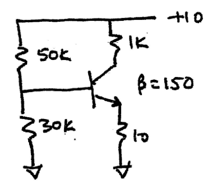

Find Vc, Vb, Ve, Ib, Ic, and Ie
Vbe is 0.7V
KVL
Vb = (10*30k)/(80k) = 3.75V
Ve = Vb-Vbe = 3.05V
Ie = Ve/Re = 0.305A
Icmax = 10/(1010) = 9.9mA
Ie is much greater than 9.9mA, so this circuit is saturated. Is this correct?
This is true iff the base current is zero or negligible.
It is better to apply Thévenin and say VB = 3.75 – IB×30k||50k
Q still turns out to be saturated, yes.
1. Substitute labels for the resistors, like R1, R2 etc. Substitute actual values only at the end.
2. Write Σi = 0 at the base and emitter junctions. Let Ve = Vb - 0.75V. Gives you 4 independent equations in 4 unknowns.
3. Assume no saturation and solve for ib, Vb, Ve and Vc. If Vc turns out to be < Ve your equations were invalid and you have saturation.
