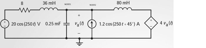

Find Va(t) using Nodal Analysis:
Zc = 1/(jwC)
Zl = jw*L
W = 250
Z36mH = j9 ohm
Z80mH = j20 ohm
Z0.25mF = -j16 ohm (is capacitor impedance always negative? It says so in my instructor's notes but I forgot why)
20cos(250t) -> 20 <0° V
1.2cos(250t+45°) -> 1.2<45° A
Are the following Nodal equations correct? Is Node1 simply Va?
Node1:
[tex]\frac{Node1-20<0}{8+9j} + \frac{Node1}{-j16}=0[/tex]
Node2:
[tex]-1.2<45° + \frac{Node2-4Va}{j20}=0[/tex]
Node1 and Node2 are just one node. Nodes are not defined by black dots. Those two dots are connected by a wire of perfect conductivity and the voltages at the two dots are the same, so they are really only one node.

I assume Va is the voltage across the Capacitor?
That looks OK; now all you have to do is solve for Va.
By the way, the reason that capacitor impedance is negative is because 1/j = -j

No, I don't get that. As a sanity check, for Va to be 4000 volts plus seems a little high to me.
What happened to your equation in post #3?
If you'll show your work, we can probably find your error.

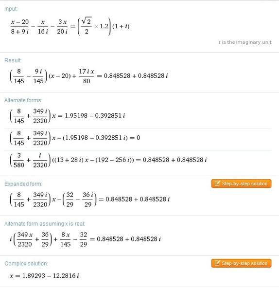

I plugged the equation into MyAlgebra.com and it spit out the answer. Here is the equation again:
[tex]\frac{Va-20}{8+j9}-\frac{Va}{j16}-\frac{3Va}{j20} = \frac{1.2\sqrt{2}}{2}+ \frac{1.2\sqrt{2}}{2}i[/tex]

I tried another calculator and got:
1.89293-12.2816 i
is that correct?

I read the output wrong, it was 1.89293-12.2816 i.

I think you may be having a problem with your complex constant j. In Mathematica there is a difference between j9 and j 9.
Without a space between the j and the 9 (in other words, like this j9), Mathematica treats that as a variable name. With a space, like j 9, that is treated like j*9, the product of j and 9. Also at the very end of your equation you have i instead of j.
What does MyAlgebra use for the complex constant, j or i? Whichever it is, put the right one in your equation and instead of j9 and j20, etc., put j*9 and j*20 (or possibly i*9 and i*20 if i is the symbol for the complex constant) and run the equation again.

This is correct.
