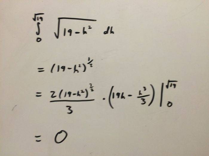

Evaluate the integral to find the area.

So I know how to find an anti-derivative for the most part. Here it's tricky because my equation has an exponent AKA square root. I tried to use the chain rule with anti-differentiation. My result was 0. I'm not sure how to deal with that exponent AKA square root.

Never heard of that. It doesn't seem to work, does it? Try to use the substitution method with the help of trigonometric identity, remember that ##a^2\sin^2\theta + a^2\cos^2\theta = a^2##.
Note: exponent is not the same as square root.
The "chain rule with integration" is "substitution"- but you are doing it wrong.
If you had [itex]\int (ax- b)^n dx[/itex] then you could let u= ax- b so that du= adx and dx= du/a. Replacing ax- b by u and dx by du/a, the integral becomes [itex]\int u^n (du/a)[/itex] and because a is a constant we can take it out and get [itex]\frac{1}{a}\int u^n du[/tex]. <br /> <br /> But if we have [itex]\int (cos(x)- b)^n dx[/itex] and try to do the same thing, we run into a problem. Letting u= cos(x)- b, we have du= -sin(x)dx so that dx= -du/cos(x). Putting those into the integral, [itex]\int u^n (du/cos(x))[/itex]. But now we cannot take "cos(x)" outside the integral because it is NOT a constant! And we cannot integrate cos(x) with respect to u.<br /> <br /> The "chain rule" with <b>differentiation</b> says that if f(x)= g(u(x)) for some differentiable function u, then df/dx= (dg/du)(du/dx). That is, we multiply together the derivatives of g with respect to u and u with respect to x. But doing the "opposite", substituting in the integral for u(x), [itex]\int g(u(x))dx[/itex] we cannot just do the integration with respect to u of g and then multiply by the integral of g. We have to have something line [itex]\int g(u(x))u'(x)dx[/itex]. u'dx= du so the integral becomes [itex]\int g(u)du[/itex]. But the derivative, u', has to <b>already</b> be in the integral. We cannot just multiply as we can with differentiation.[/itex]

You have errors on every line of the work you have done. Here is your work, reproduced using LaTeX, with comments.
##\int_0^{\sqrt{19}} \sqrt{19 - h^2} dh##
##= (19 - h^2)^{1/2}## No. All you have done is to remove the integration symbol.
##= \frac{2(19 - h^2)^{1/2}}{3} \cdot (19h - \left. \frac{h^3}{3}) \right|_0^{\sqrt{19}}## See comment below.
##= 0## Not a reasonable answer. The integral represents the area of a quarter-circle, whose area is not zero.
From above:
No, this isn't how it works. To get ##19h - \frac{h^3} 3## you integrated ##19 - h^2## but ignored the fact that ##19 - h^2## is raised to the 1/2 power. You can verify that your integration is incorrect by differentiating your antiderivative. For example, ##\int x^3 dx = \frac {x^4} 4 + C##. If I differentiate ##\frac {x^4} 4 + C##, I get ##x^3##, the integrand I started with.
