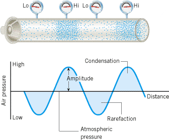

When a loudspeaker moves back and forth, sound is generated. The moving of the loudspeaker diaphragm causes condensation of air when it moves outward, and rarefaction of air when it moves inward. When this movement is happening at a certain frequency, we hear a sound. See for example this illustration:
https://www.physicsforums.com/attachments/sound-gif.84528/?temp_hash=012fb293b7e650bf392ecc98c949c953​
I was thinking about this and I understand we perceive the condensation/rarefaction as sound. But what happens if we have only one or the other? I.e. if we have a loudspeaker only moving from it's initial position outward ONCE, only condensation of air happens. In the illustration above, this would correspond to only one crest of the wave, but no trough.
Same question goes if the loudspeaker only moves backwards from it initial position once, so there's only rarefaction (one trough, no crest).
So my questions are:
1. If ONLY ONE condensation (one "crest") is happening, will we still perceive it as sound?
2. If ONLY ONE rarefaction (one "trough") is happening, will we still perceive it as sound?
3. If the answer is yes to any or both of question 1 and 2, are the sounds in 1 and 2 different from each other? If so, how?
4. If the answer is yes to any or both of question 1 and 2, are the sounds different from a sound that contains both condensation and rarefaction? If so, how?

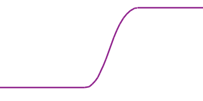

The premise almost works. You would have a pulse that quickly drops to ambient after the speaker finishes its movement. It would overshoot on its way to ambient, I'd wager, thus conserving mass. So in that sense it's still one wavelength, not half a wavelength as originally proposed.
Regardless of half versus full wavelength arguments, a single pulse is tantamount to an infinite wavelength, which is a frequency of zero. We do not perceive sounds below 20Hz. Elephants can perceive sound down to 10Hz.
But 0Hz is not a sound. It is simply a shock wave. And I don't think it's physically possible to have one alone.

You're right. If it were a single overpressure, followed by a return to ambient, you would be able to determine the frequency and wavelength.
I read the OP as suggesting an overpressure without return (really, that's a quarter of a pulse). Subsequent posts suggest this is the general assumption.
Sorry for not having posted here the last days, I was on a trip. I read your replies, and I feel like I should clarify my original question. I don't know why the image in the original post disappeared, as I uploaded it here as an attachment in the forum, are these attachments just temporary, i.e. disappear after a while? Anyway here's the image again, from an external url:
On the illustration there is the result of a loudspeaker vibrating forward (causing condensation) and back (causing rarefaction). I think the question might include several questions, so let's take them one by one.
1. Assume that the speaker, instead of moving forward and back (like regular when sound is heard) it is only moved forward ONCE. Since forward movement (i.e. x>0 from initial position, x=0) causes condensation and backward movement (x<0 from x=0) causes rarefaction, only one forward movement would cause only condensation, right?
2. If the above physical condition is not possible to create only a condensation, would there be another situation where it would be possible? DaveC and jbriggs suggests some kind of shock wave or pulse. Could such a shock wave/pulse be created physically?
This image is not correct, instead look at the illustration above, remove everything below the x-axis. Now you have two crests. Remove one of them. So there is what I am trying to determine, only one crest (condensation).
