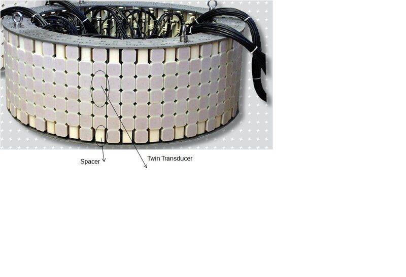

I do want to do theoretical calculations only as actual array is not in my hand. The sketch of array is attached here, it consist of 96 customized 'Twin-Transducers'. Only estimated TVR values of these transducers are known.

It looks to me like you have transducers embedded in a cylindrical wall, so transducers on the far side cannot be seen directly. Each elemental transducer will have a radiation pattern that I believe you are describing as isotropic when it is actually semi-isotropic because of the cylindrical wall.
1. Is that correct ?
2. Will the transducers be driven synchronously in phase, or will the phase be controlled individually to synthesise a maximum EIRP beam?
3. You give the dimensions of the array element distribution on the surface of the cylinder, but no idea of the range of frequencies involved that will determine the wavelength in the water.
Basically, as a phased beam radiator; 4 rings of 32 transducers = 4 * 32 = 128, but only half are visible, so 64 elements = 26 are in line of sight.
Each doubling of the energy in the beam will give a 3 dB increase, so 26 elements will give you a; 6 * 3dB = 18 dB array factor to add to the SL in dB of an individual sensor.
If the sensor has an SL of a dB, the array will give a maximum SL of; a + 18 dB.
For n = 96 / 2 = 48;
Array factor = ( 10 * Log10( 2 ) ) * Log2( n )
Change of base …
10 * Log10( 2 ) = 10 * Log( 2 ) / Log( 10 ) = 3.0103 dB
Log2( n ) = Log( n ) / Log( 2 ) = 5.585
Additive array factor = 3.0103 * 5.585 = 16.81 dB

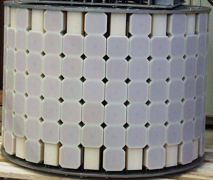

Thanks for reply. I am attaching another picture of array for clarification purpose.
1a. It is a complete cylindrical array immersed in water and can transmit evenly in all directions and open on all sides i.e. no cylindrical wall.
1b. I do not have radiation pattern of 'Twin Transducer' but most probably it will have cosine shape beam pattern due its shape.
1c. These transducers are backbaffeld i.e. transmitting from front phase only.
2. As per my understanding, in ODT Mode i.e. Omni Directional Transmission Mode, no phase adjustments will be applied and all transducers should be simultaneously driven (synchronously). In RDT Mode i.e. Rotational Directional Transmission Mode, Cylindrical Array can be divided into equal sectors e.g. 3 sectors and for each sector independent transmit beamforming can be applied using proper phase adjustments.
3. Array operates in frequency range of 6-9 KHz
My confusion is that if i drive all Transducers simultaneously in ODT Mode i.e. without any phase adjustments, should i include"Array Factor or Gain" in SL calculations? In my understanding, Array Gain should be added only when doing beamforming using phase adjustments.

I assume you mean the “front face”.
The elements form a cylindrical wall behind which there are baffles. The elements transmit from their front surface only, so elements on the far side of the array will not radiate on the near side of the array.
Are the pairs driven differentially as a dipole? How do you know which pair is a pair? I notice the rings of elements are staggered = feathered, probably to reduce side-lobes.
If a ring is driven in phase, then because the 6 elements in each column are staggered, each alternate column will be connected in reverse.

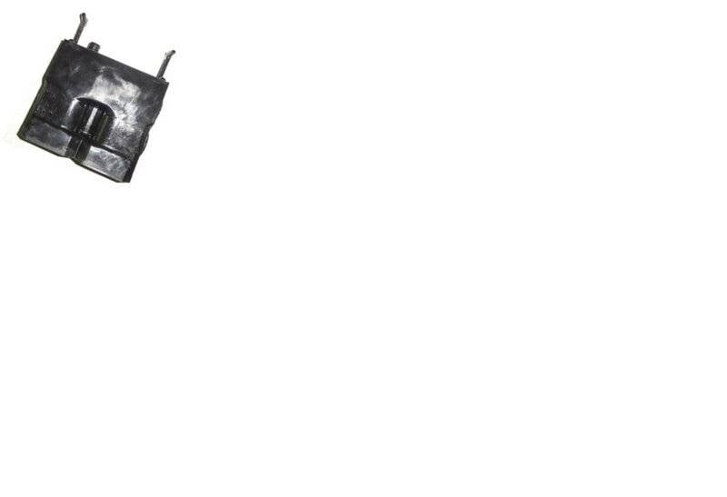

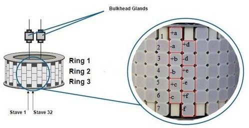

What i know for sure about this array is that it has total of 96 channels (96 Twin Transducers) each driven with separate Power Amplifier (i.e. total of 96 Power Amplifiers). Furthermore, there are 32 vertical staves arranged in a 1m dia circle with 03 Twin Transducers in each vertical stave as highlighted in the figure in my previous post also.

It appears that a twin transducer is a two square dipole, one above the other, in the same stave.
The individual vertically staggered staves of six elements, will appear to be seven continuous rings formed about the vertical axis. Each ring will radiate an amplitude of A = ai·sin(t);
The coefficients ai for the rings will be [ +½, –1, +1, –1, +1, –1, +½ }
The top and bottom rings radiate half the power since those rings are half populated.
The negative sign gives a 180° phase reversal.
Without phase control to synthesise a beam, the radiation pattern will be symmetrical about the vertical axis. The signal wavelength, ring separation = transducer pitch, and ring diameter = 1m, will determine the angle of the main lobes in the conical pattern. (Depending on depth, there may also be a reflection from the water surface).
To find the beam pattern when all transducers are driven synchronously, you will need to integrate the radiation from all parts of the near side, of 7 rings, over an arc with a fixed azimuth. That will include, or be multiplied by the two dimensional cosine response of the individual dipole transducers.

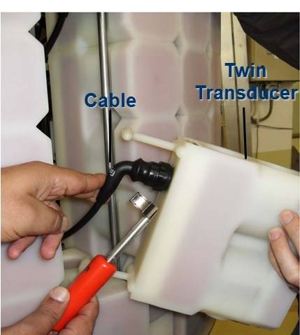

I think i could not explain the 'Twin Transducer' properly. I have attached another photo of 'Twin Transducer' for further clarification. It is for certain that each 'Twin Transducer' have common cable which indicates that both units in 'Twin Transducer' are internally connected some how. In my opinion, when we apply common voltage signal to both units of 'Twin Transducer', a cosine beampattern will be formed of a 'Twin Transducer' so we should consider 'Twin Transducer' as single transducer from cylindrical carray point of view.
The single block appearing above and below alternately in each 'stave' as shown in 'Cylindrical Array4.jpg' in my previous post is not a transducer and is acting only as spacer.
The 1m dia is only approximate and can vary few cms.
  • Photo of a white foam-encased twin transducer with a black cable entering its side; a hand in a glove holds a red-handled tool near the connector, and the label Twin Transducer and Cable are overlaid in blue.
The twin_transducer.jpg in post #8 shows the twin ceramic squares with the cut corners.
Please provide a web link to the device you are attempting to interpret and describe.
Without accurate information I am wasting my time.

If you model each twin transducer as a dipole radiator, centred at it's midpoint, you end up with three staggered rings. That makes analysis of the array difficult because it hides the vertical position of individual radiator elements.
Alternatively, when a twin transducer is driven, it appears as two equal and opposite radiating poles with well defined positions. That is why I see 7 rings of poles. I have numbered those rings from the top.
By reversing the phase connection of the twin transducers in alternate staves it makes a simple synchronous array that can be analysed as 7 continuous rings of like poles.

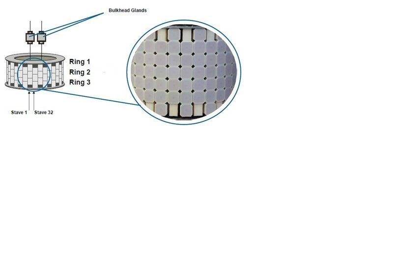

Diagram of a cylindrical acoustic array with bulkhead glands at top, three labelled rings and staves 1 and 32 marked, with a magnified inset showing rows 1 to 7 and pole labels +a to +f and -a to -f.
Ok. If i drive all transducers simultaneously with same signal with same phase i.e. without any phase adjustments/beam forming, should i get the Array Gain/Factor in my SL calculations?
