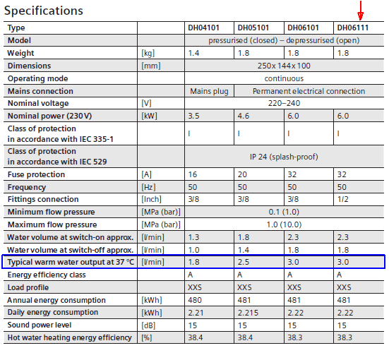

Jonathan212 said:
You are misapplying the manual: the 37 degrees-3 LPM pair assumes a standard input temperature that is not available here so it is a pointless thing to say or test for.
Outlet temperature (37°C), flow rate (3.0 LPM), and power (6KW) are given. Inlet temperature can be calculated, and works out to approximately 8°C.
8°C (48.4°F) seems a reasonable value. Several years ago at the plant I measured city water temperature at the mains meter from early January to early August to get a sense of seasonal variation, and found it ranged from about 40°F during a cold snap to 70°F during a heat wave.

n.b. @Jonathan212 said he had the DH106101 (one column to the left of the one indicated by your arrow), the specs for which are exactly the same, except that the fittings connection is 1/8" on the DH106101, and 1/2" on the 111, and no, to anyone who might suppose otherwise, that doesn't make a whit of difference, except possibly to robustness, and the 111 has a green 'on' lamp, which also has zero effect on performance.
  • #65
You're right. My bad :)

Sorry I'm late to this, I had read it on my tablet and it was too hard to respond there. I may have missed it somewhere, but I really think the solution is far simpler than where these posts have headed.
I really think that trying to work to increase pressure/flow at the input is barking up the wrong tree. From the OP: "probably as it senses low inlet pressure." - The heater sense flow, not pressure. There was a chart in post #62 that showed the turn on/turn off points to be at 2.3 and 1.8 L/min. So once you are drawing hot water, you need to keep the flow above 1.8L/min, or the heater will shut back off. As the OP mentioned the problem is worse in warm weather, this makes sense, the user adjusts the faucet for a hot shower, but that takes less draw from the hot side in the mix, since the cold side is warmer in warm weather. This was touched on in post #5, but seems to have gotten lost.
The simple solution is to run a separate hot water faucet as you shower, to bring the total flow of hot water higher than 1.8L/min. Somewhat wasteful yes, but that's the simple solution.
My shower is ~ 4L/min total flow. OP should measure theirs. This was asked in post #37, but was rebuffed by OP. I guess maybe they don't want help?
I think another, more complex and costly solution was mentioned, to add a small-ish tank heater at the output, to buffer the on-demand heater. But that will also go cold eventually w/o enough flow to trigger the demand heater on.
