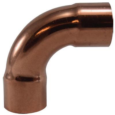

  • #43
What is the formula at 90 degree turns?
  • #44
Jonathan212 said:
What is the formula at corners?
I do not know what your sentence means. Is English your first language?
  • #45
I meant 90 degree turns of the pipe.
  • #46
If I understand your question there are factors for determining the added loss at elbows in terms of equivalent pipe length to be added. According to Crane Fittings the factor for a std 90° elbow is L/D = 20-30 so the maximum equivalent pipe length to be added to your current pipe length is L = 30 x pipe I.D.
Actually I have both elbows and turns in the path, what is the formula for turns of a given radius and internal diameter?
