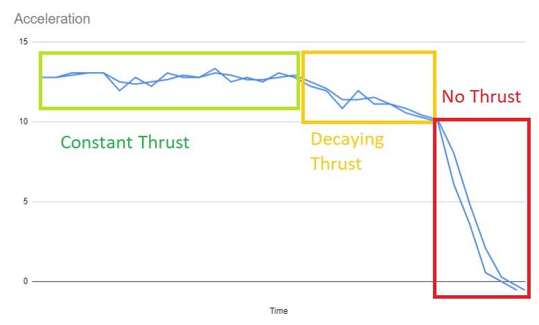

An Electron launch failed during the second stage burn. The reason is not clear (or public) yet.
Video - at 5:40 into the flight, shortly before they discard empty batteries, the velocity suddenly stops increasing (22:10 video timestamp)

Edit: Here is an acceleration plot. The final stop is the most notable but thrust went down before.
Could you post image or table of acceleration directly? Twitter is blocked on my side.
Youtube video, also by Scott Manley
~5:20 has the acceleration
Image alone:
Line graph titled Acceleration against Time, with two blue traces. Three boxed regions: Constant Thrust (acceleration about 13, roughly flat), Decaying Thrust (falling from about 12 to 10), and No Thrust (dropping steeply from 10 toward 0).
Image alone:
Thank you.
After re-checking the video, seems it was indeed logo peeling off.
Regarding acceleration and camera feed, it is consistent with fuel slosh resulting in either engine damage or automatic engine cutoff. Seems the mild roll and yaw oscillations were coincident with thrust reduction, and rocket yawed sharply seconds before video termination.
