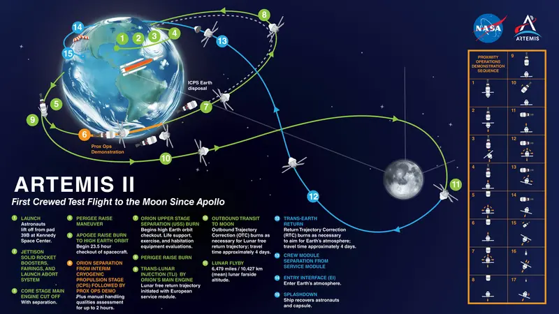

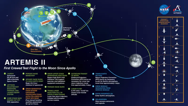

mr3000 said:
I heard that there might be a manned mission to the moon in 2026.
Is this true?
Filip Larsen said:
You likely heard of Artemis II which is planned to be the first crewed test of the Orion capsule for a 10-day trip around the Moon (with no landing):
mfb said:
The rocket for Artemis II will roll out in two hours
Alternative coverage
The launch is still planned for February 6.
It will be the first time in over 50 years that humans leave low Earth orbit again, and fly around the Moon.
CNN has an article, but I feel like there should be more coverage of this. Seems like kind of a big deal.
https://www.cnn.com/2026/01/17/science/nasa-artemis-ii-moon-mission
