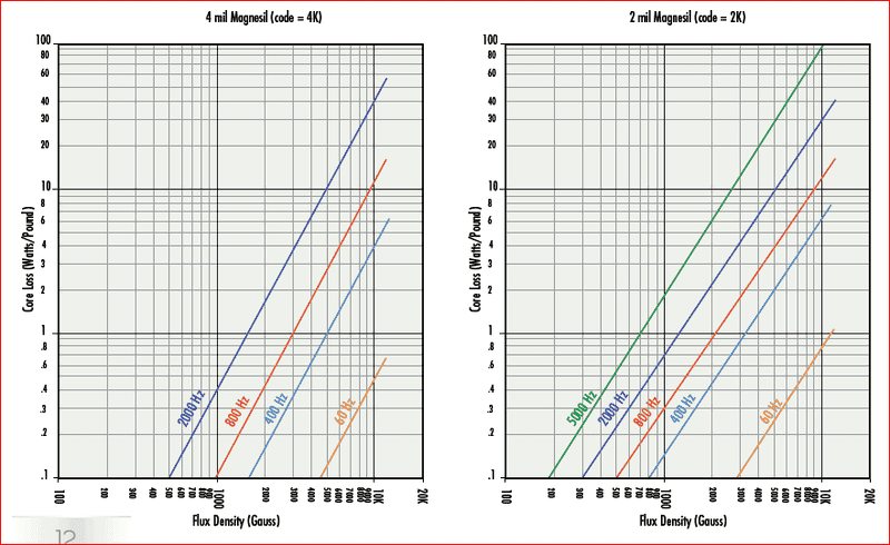

I don't know if this is anything like what you're after... every supplier should have "Brag Sheet" extolling the virtues of his products. This one's from an old line US manufacturer, "Magnetics". They sell worldwide .
Two log-log graphs of core loss in watts per pound against flux density in gauss, for 4 mil Magnesil (code 4K) on the left and 2 mil Magnesil (code 2K) on the right, with diagonal lines for frequencies of 60 Hz to 5000 Hz.

Yes sir.
I am trying to find out from given information.
