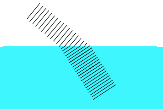

The reason refraction made sense to me was that as light entered a denser medium its speed decreased and due to its frequency remaining the same the wave length also decreased, balancing the equation c=f.<lambda>. This change in wavelength was then responsible for the change in direction:
